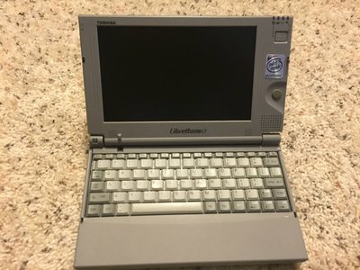

Toshiba Libretto 110CT
Video Review by me: https://www.youtube.com/watch?v=Wr25E0JoL0A
248.88 KiB
3026 views
255.16 KiB
3026 views
Specs:
CPU: Intel Pentium 1 (P5) with MMX at (233MHz)
Chipset: Custom Toshiba Chipset (Similar to a Intel 430TX)
Ram: 96Mb of EDO Memory (Using modified Portege card)
HDD: 8GB Compact Flash Card @ 800x with PATA Adapter
Screen: 7.1" TFT Active Matrix LCD
Video: Neomagic 2160 - 128xd (2Mb Video Memory)
Sound: Yamaha OPL3-SA3
OS: Windows 98se with unofficial SP3 applied

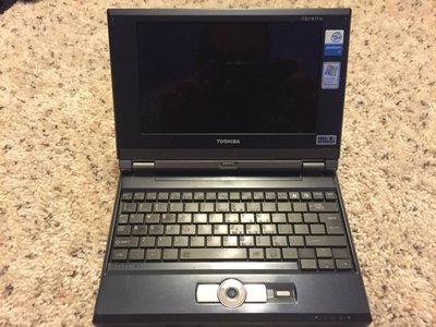

Toshiba Libretto U100
232.6 KiB
3026 views
278.01 KiB
3026 views
Specs:
CPU: Intel Pentium M at 1.2 GHz
Chipset: Intel 855GME
Ram: 1Gb of DDR Memory
HDD: 32GB KingSpec PATA SSD
Screen: 7.2" TFT Active Matrix LCD (Glossy)
Video: Intel Extreme 2 (Works great for 3D gaming in 1996-2001 ERA)
Sound: Analog Devices AD1981B (Hadn't had an issue with DOS games recognizing this as a Sound Blaster)

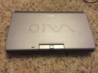

Sony Vaio PCG-C1XS (Picturebook)
Video Review by me: https://www.youtube.com/watch?v=8QIaMFxrtWQ
318.57 KiB
3026 views
CPU: Intel Pentium II at 400 MHz
Chipset: Intel 440ZX-M (Same as a 440BX with Mobility enhancements)
Ram: 64 Mb of SDram Memory
HDD: 16GB KingSpec PATA SSD
Screen: 8.9" Active Matrix LCD
Video: NeoMagic MagicGraph 256AV (2.5 Mb)
Sound: Yamaha DS-XG

Thanks guys for your kind words! I was shooting for finding machines that are Intel genuine, with a sound card that are supported in DOS. One quick note for those looking at getting these models. The Toshiba Libretto's I think are the best models for the task. One of my main complaints on the Sony is that there is not "Stretch Screen" or "Display Stretch" in the bios option, making in DOS Game hard to see on the Wide screen display. I tried posting up the BIOS in BIOS-MOD forums to see if it could be unlock but no one seems interested and its little beyond my skill set to start messing around with the bios boot code.
RacoonRider- I have a teardown video for the Libretto 110CT on my youtube channel that explains what I did to get the CF Card working correctly. - https://www.youtube.com/watch?v=mdNUJ1Fk3tY
Oerk - Thats awesome thank you for the feedback and recognizing I'm doing this without any emulation. One note on the Libretto U100, the sound card isn't as much as an issue with DOS as the Video card is. I find the Intel Graphics card struggles with VESA emulation within dos. Not sure if this a driver issue or in fact that the graphics card may be to new and doesn't support some of the modes for a few DOS games call for. To counter this, I have to run some games that have this issue in 320x240. On a few extremes I just use DOSBOX. For 3D acceleration within Windows 9X shouldn't be an issue. I haven't found a game within 1996-2001 that wasn't really able to play at full graphics yet.
