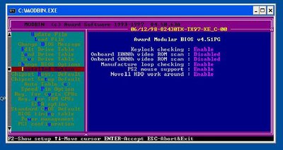

My Asus TXP4-X have old Award bios. I use the Asus TX97-XE in it anyway, but both bioses cannot be opened using normal Modbin version that I use for all these Award bioses, claiming that "bios is not version 6.0":
Now... witch version of Modbin is possible to use there? I need to look, if there can be unlocked TRP (precharge) settings to lower value that too slow 3... Because I don't know any MemSet equivalent that let me change the Intel 430TX ram settings 🙁
Anyone can suggest application that can open this bios?

I recently went through the same issue with an old 4.50G bios in my Lucky star motherboard.
Try the version I have attached.
EDIT. I just tried it with Your bios, works fine. Unless You are a serious bios hacker there doesn't appear to be
too much You can adjust.

That version of Modbin does not work under WinXP, right? Because it did not start for me, while all the v2.02+ versions can be used under WinXP... And you say that there is no way to set / unlock the TRP to 2? That is very very sad...

I used Winxp 32bit and it worked fine. If You are using 64bit then it won't work. Download Hiren's boot cd and boot
off of Mini Winxp if You need 32bit, then run the software from Your hdd.
Hit F2 in modbin for more options, I only just discovered that.

What do you do that it works for you? For me, even when I start it from the shell, it just silently exit and that it is. It says "cannot execute":
And I run on 32bit WinXP (old P4 used) ... so I did not understand, why it cannot start.
F2 gives more options? Sounds good. Mine Modbin v2.01.02 only (after F2) save the bios and all the modules from it to rootdir anc exited...

The version I posted above works fine on my home computer and my work computer which runs a Virtual Winxp32. No idea why it doesn't work for You.
