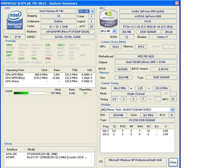

Reply 6 of 13, by BSA Starfire
89.72 KiB
4839 views
Never tried my system with 98 but I can confirm that it makes a great windows XP platform, quick, quiet and very stable. Here is my Hwinfo screen. I use this machine daily for most all of my everyday tasks.
Reply 7 of 13, by Rhuwyn
Looked up MS-9625 on ebay and it looks like someones got those stocked int he UK for less then 14 USD a board. Only wish the shipping wasn't almost 23 USD. Still not a horrible deal though. Also looks like the 915 series chipsets have Windows98 support.
