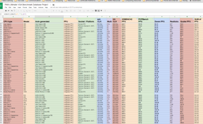

Reply 19 of 62, by PhilsComputerLab
Rank Hardware Mod
Hardware Mod
NooNaN wrote:
how does that stack up?
Ok, that helped a lot. Attached a screenshot of similar machines in their results.
There is something seriously holding back your machine. It should perform ~ twice as fast.
Try booting into DOS-mode, then run that DOS benchmark again and choose option 6 or 7 to show the CPU clocks.
FSB should be 66 and multiplier 6x for a frequency of 400 MHz.
Check if there is a turbo header on the motherboard.
I would remove any cards not in use, and figure out what's going on.
