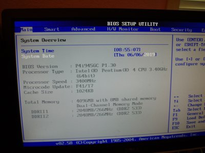

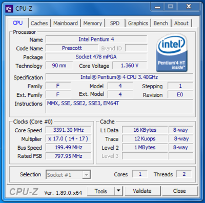

Reply 15 of 30, by MrGenius
Sorry for the necro. But this is one of the only threads on the subject I could find on the web(other than this one). And I do have some relevant info to add. At least I think I do.
Anywho...I've got an SL7Q8 that I've been trying to get running on my P4P800-VM. I'm having a similar no boot issue. The system will power on. Then it throws a long list of "Unknown BIOS error" codes. After which point it hangs. Figured it was just a missing microcode issue. But it doesn't appear to be. I've checked the latest BIOS for the P4i945GC(which is known to run these things). It doesn't have any microcodes that the latest BIOS for the P4P800-VM doesn't also have. And, specifically, it(latest P4P800-VM BIOS) already has the MBDF4117 patch(that's supposed to be the ticket to ride). As well as the other 4 for Prescott. So...if nothing's missing...there's nothing to add. Where to now?
TL;DR
There must be more to it than the microcode. Which I have no clue as to what that might be. So I'm most likely just going to grab a P4i945GC and call it good. Unless someone has a better idea.
Why bother? Well...if for no other reason...to prove to the "you know whos" above that they're a couple of "you know whats". That being said...I SHALL RETURN...PREPARE TO BE SCHOOLED FOOLS!!!
UPDATE 2019-6-6:
CLASS IN SESSION!!!
Got the P4i945GC. Installed the SL7Q8. Booted and installed Windows 7 Ultimate 64-bit. 100% successful installation with no issues whatsoever.

Logistics wrote:
As was stated above, it matters not--there is no such thing as a 64-bit s478 processor.
WRONG!
Logistics wrote:
However, I would definitely not suggest anyone run 64-but on early 775's that barely had EM64T as it just runs slow. Disabling HT on my old 3.2GHz single core was a huge upgrade in itself, but 32-but XP and 7 both ran better in 32-but, and it had 4GB of RAM.
As far as 64-bit running slow on a CPU that "barely has EM64T"...that's a full on crock of shit. I've run many early 775s, and possibly one of the(if not the actual) earliest Socket 478s, with EM64T and NONE of them have run any 64-bit version of Windows "slow". No noticeable difference really. But, if anything, 64-bit is slightly faster.
As far as disabling HT...never seen ANY performance gains from doing that either(with early or later HT CPUs).
You seem to be spouting some uninformed BS internet mythology with no basis in reality. 😉
CLASS DISMISSED!!!
