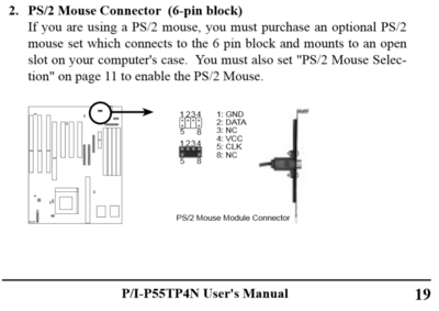

ok i checked my jp7 settings.. theres a cluster of 3 jumpers there.. the top + bottom ones are set to 1+2 and hte middle one is set to pins 2+3 (the manual says not to change it) so according to the manual the ps2 mouse is enabled.. at least according to the jumper setting.. next to it - it says irq12.. maybe i have something stealing irq12?
to tayyare:
the ps/2 header on my motherboard isnt in a single line like that.. its a 2x5 configuration
heres a pic (not of the exact board i have, but a similar board with similar 2x5 ps2 header)
file.php?id=19295&mode=view
im booting win98 off a cf card and everytime its "windows did not detect a mouse attached to the computer.
id really like to start using this 486.. this is the only obstacle in the way of me enjoying And setting this computer up with a new os + programs installed

Reply 7 of 100, by alexanrs
Before suspecting software issues you need to be sure your PS/2's backplate connector matches the pinout of the header on your motherboard. Since this motherboard came with the header soldered on, I REALLY doubt it came with a BIOS that doesn't support it.

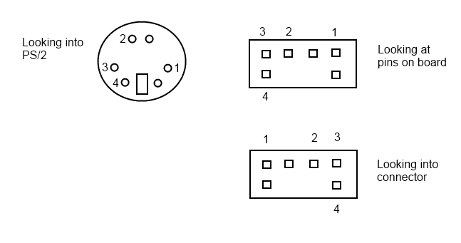

Reply 8 of 100, by firage
I have the pinout and I can confirm it works:

Reply 9 of 100, by chrisNova777
wow im an idiot.. ok the pinout of the adapter i have is 2x5...
the actual pin of the header.. as shown by your document u just posted is actualyl 2x4!!!!!!
i bought the wrong stupid ps/2 header.. Model: PLATE6F from startech.com http://www.startech.com/ca/Cables/Serial-Para … Bracket~PLATE6F .. wrong one for this motherboard;(
does anyone know how i could change the pins inside the header connector? because it will obv fit on with 2 pins hanging off to the side. if i could only rearrange the pins in the connector.. but i dont know how this thing works.. do i need a special kind of tool to eject the pin connector/wire into the black pin header?
i cant believe this is the reason.. 🤣 i feel so stupid.

Reply 14 of 100, by chrisNova777
ok i found this previous vogons post: PS/2 Bracket for Asus Motherboard Header
and following the instruction i used a screwdrivr to pullback the plastic tabs to be able to remove the wire/pins from the sockets and re-arrange them
but unfortunaetly i must have made a mistake because im still getting the no ps2 mouse screen 🙁

Reply 19 of 100, by chrisNova777
yea well nothing is working.. maybe i should try changing the jp7 jumper even tho from what i can tell it looks to be enabled already
the yellow wire is the voltage right? pretty sure i have that in the right location on pin 4 (top left)
question is.. which color is ground? data? click?
like i said i have yellow + red,green,brown wires
