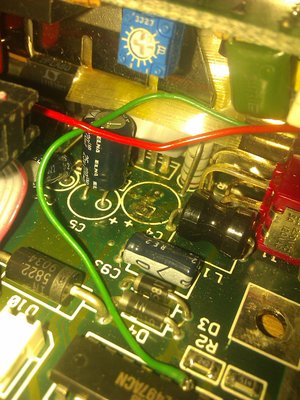

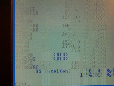

i have this little Bondwell B310 Laptop with 40Mb Harddisk and Harris 286 12Mhz CPU.
It had a defective Capacitor in the negative voltage for the LCD Contrast.
110.35 KiB
493 views
202.11 KiB
493 views

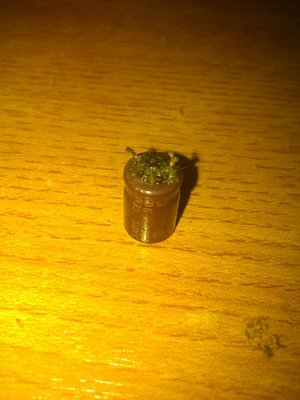

but after i replaced the capacitor, the new one got hot and died too.. (polarity right)
On + of C4 i read a Voltage of -12.5V.
Has someone encountered a similar Problem and knows what i have todo ?

I think You are in luck, as someone posted a vid on Youtube of a repair of one of these just Yesterday. Go here https://www.youtube.com/watch?v=5QdprppIXPY
At 4.18 You can clearly see that the negative pin of C4 is closest to what seems to be the + symbol. Most likely the reason there is a square where the pin goes
instead of a circle for the other capacitors. I would say You likely were bumsteered by the + symbol into putting the capacitor in the wrong way round.
In negative voltage rail circuits the positive pin of the capacitor goes on the Ground and the negative pin goes on the negative rail, -12.5v in this case.
Reply 2 of 2, by matze79
Thanks, so it whas my fault.. 😀
Now its working Perfect!
i just suck the solder off with my desoldering station and the capacitor felt off.
And expected + to be + of the capacitor.
