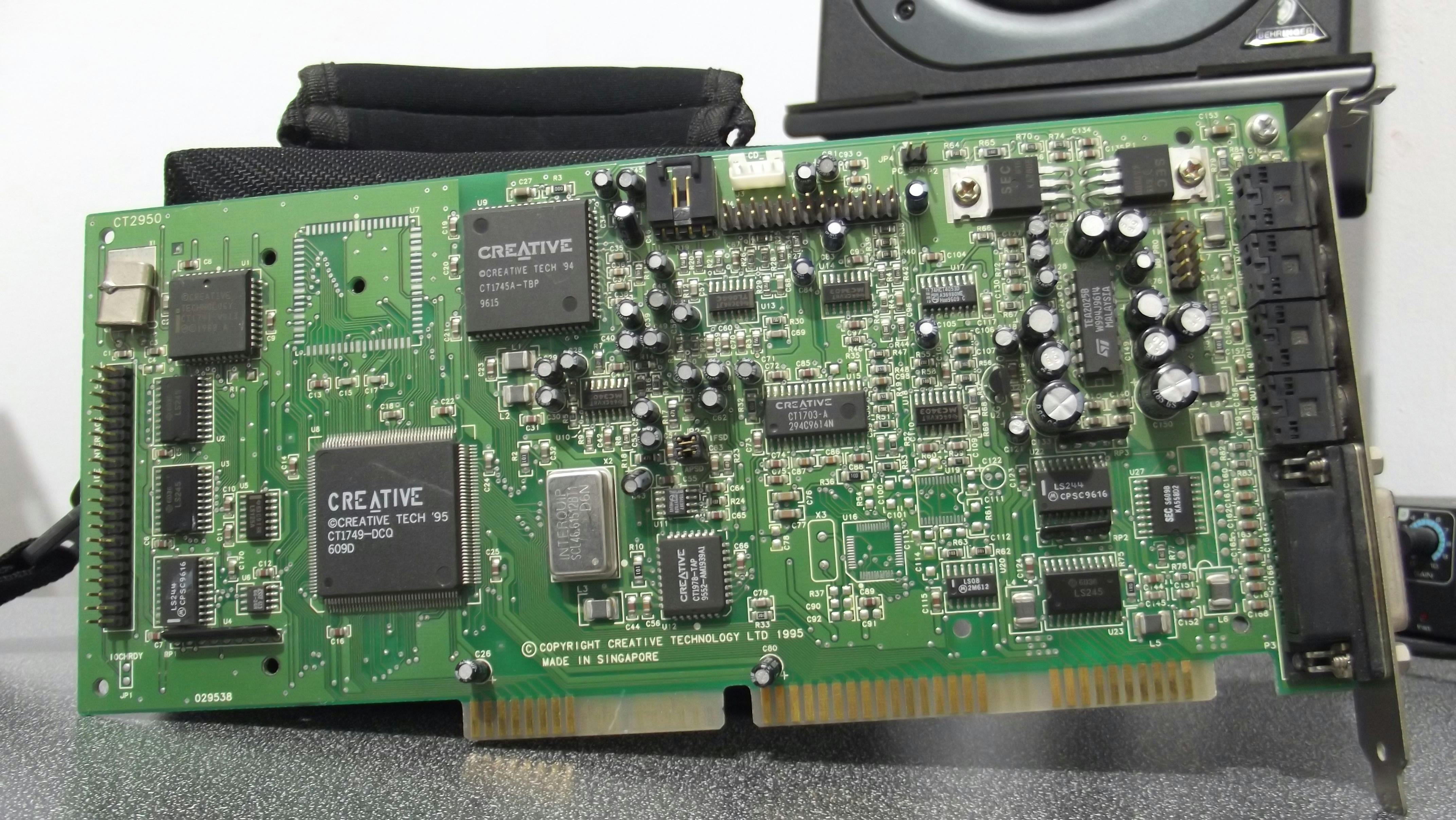

Yes, the CS4232 sounds better than dosbox (but similar) and definitely better than my CT2950, or at least closer to what I remember it was in the 90s.
Okay, waiting for my Yamaha YMF719E.
For the sake of it (no wonder it was cheap), here's my CT2950 (what not to buy):
* Huge closeup of the CT2950 so the chip names are readable (and not a single Yamaha).
http://www.mediafire.com/convkey/4d90/pocbx9fdadasjf8zg.jpg
All in all, the CT2950 with the integrated CQM instead the original Yamaha YMF262 (OPL3), sounds not bad at all, but a little different to the original.
That's not to say that the game will sound completely different, it will not, it will sound like your game but slightly different (I'd say 90%+ there).
Anyway, much better than the PCI128 I used before the CT2950, which uses god knows what for the OPL emulation and sound like a completely different game.
BTW, the original question is still open, where the OPL of dosbox came from? Based on what?

The Yamaha YMF719 is here and I've already recorded it to have a clear comparison.
Guess what?, Dosbox is 100% accurate to the point that I can't distinguish between the real OPL3-SAx and dosbox on professional studio monitors with ribbon tweeters.
The waveform of dosbox on the distorted guitars is more similar to the OPL3-SAx (YMF719) than to the to the CQM (CT2950), although not similar.
The distorted guitar waveform is a top-half triangle waveform, which dosbox creates to perfection but the real sound cards skew to some degree.
If I would have to guess, I would say that Dosbox emulated the behavior of the OPL3 chip without the peripheral hardware that may affect it's sound.
Anyway, hope it helps other people for future reference.
