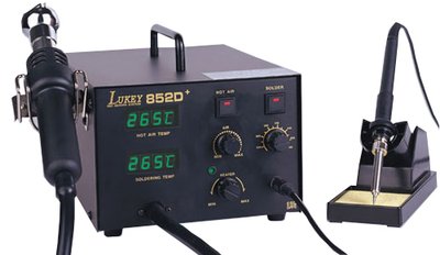

This is what I use for soldering / de-soldering:
88.29 KiB
603 views
25.36 KiB
603 views
The solder / hot air station was pretty cheap (about 120 euro) and it has lasted me for going on 6 years now. Finding solder tips for it is pretty hard since it uses an unusually thin tip, but the great advantage of that is that the soldering iron reaches 480 Celsius in about 60 seconds. The hot air pump is really handy too for removing / soldering surface mounted parts, but on my station it doesn't get as hot as I'd like it to. The yellow heated solder sucker I use is just a cheap Chinese one I payed 10 euro for. Does the job pretty well and it's easy to clean.

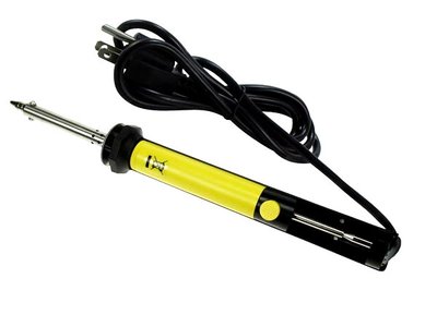

I also have one of these:
38.66 KiB
603 views
Also decent, was also really cheap (about 20 euro or so), tips are easy to find but it takes forever to heat up unlike the Lukey soldering station.
With these alone I've replaced simm slots, an ISA slot, removed an intel DX4 from an ISA comm device and replaced countless capacitors.
