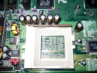

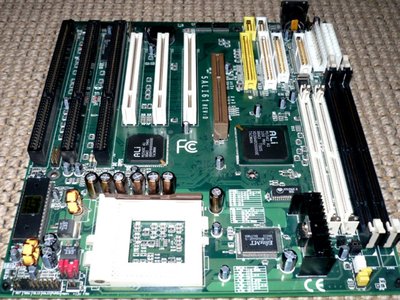

Reply 19 of 79, by PCBONEZ
The board was working fine then suddenly has a problem with 4 different video cards (with beep codes for it) and possibly RAM problems.
The Vcc for the AGP slot is 3.3v but that may or may not be provided by 5v via a DC-DC step-down regulator.
The situation is similar for RAM slots and the RAM behavior is also suspected by the OP.
When 5 parts suddenly have issues it suggests a power problem and most power problems on old gear are caps related.
I assumed the OP would see bloated caps on the board so I suggested the PSU being at fault.
I have since found a photo of this board showing bloated caps. Will attach pics. See flagged caps in pic 2.
The thing about bloated caps.
- Bloated caps tell you for sure they are bad.
- Unbloated caps do not tell you the caps are good.
Only about 1/2 of bad caps show any visible signs.
Now that two PSUs have been tried the motherboard caps are the prime suspect.
As to checking the PSU caps. I was just suggesting he take a peek in there for any obvious caps problems.
I wasn't suggesting working on it.
