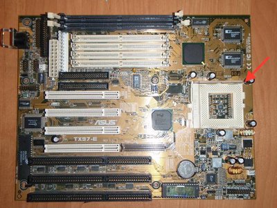

While installing the CPU, I am using the "earmarked" corner as the reference. The CPU has it, and the socket has it in pins. So I think I'm putting it correctly. Here is the photo of the mobo from the internet

Just so we're clear, the first pin in the jumper is where the red arrow is on the picture, right?

Reply 16 of 24, by Tetrium
jheronimus wrote:
Just so we're clear, the first pin in the jumper is where the red arrow is on the picture, right? […]
Tetrium wrote:
Make sure all the jumper settings are correct (doublecheck em!)
A bigger picture for reference
Not necessarily. Most of the time the first pin has a thicker streak of (white) marking, like an extra thick line (on the mobo itself).
Often enough the first pin is not right next to where the jumperpin designations (like "FSB") are, so in your screenshot, the red arrow might as well be in the top right corner

Reply 17 of 24, by Tetrium
Just to be clear, you did put the red arrow in the correct corner (if I am to believe the manual you linked in your first reply) 😀
