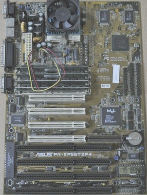

Reply 3 of 26, by shamino
I noticed there's a later revision 3.00 board with the same name but a very different layout.
316.96 KiB
3470 views
picture from eBay
The rev3.00 manual says it supports split voltages but only down to 2.5v. I don't know if that manual was meant to apply to the rev1.4 board.
The older version (I think it says 1.4?) appears to have a linear regulator for the CPU, while the rev3.00 is a switching type.
From appearance I'm not sure the rev1.4 board would support split voltages. It's picture shows a missing 2nd regulator that it would probably need for that. I think the regulator with the large heatsink would be the 3.3v supply. I'm just speculating from the appearance though.
Reply 4 of 26, by vetz
I have both revisions. Rev 3.0 is the one you want. Shamino is correct in his post.
Rev 3.0 has:
- coin battery
- better CPU support
- more voltage options
- 512kb cache built in
- ATX connector (rev 1.4 sometimes comes with only AT connector)
The ATX version of XP55T2P4 does not have 83mhz FSB option which the AT version of the board does have. Other than that it is a kick ass board with great performance and compatibility. They are very stable and troublefree. There should be AMD K6-III+ support and BIOS hack for 128GB harddrives on the IDE if you go here and download: http://web.inter.nl.net/hcc/J.Steunebrink/k6plus.htm. You can set the multiplier to 2x on the K6's which translate to 6x = 400mhz.

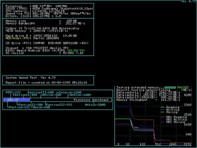

Reply 17 of 26, by Skyscraper
RacoonRider wrote:
I remember seeing somewhere a speedsys picture of K6-3+ where L3 (motherboard) cache worked actually slower than RAM 😁 Does too complicated caching scheme render the point of L3 obsolete?
It depends on the chipset and probably alot of other factors. With VIA MVP3 you want to use the L3 cache and keep within its cacheable range (128MB with 512KB, 256MB with 1MB and 512MB with 2MB cache).
I posted this image in another thread to show the memory and cache performace of VIA MVP3 with a K6-3+, the motherboard is a PC Chips M577.
264.34 KiB
3258 views
