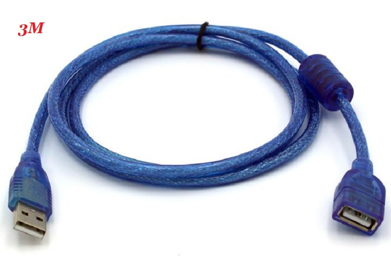

A month ago I bought a powered (active) USB hub, and a blue-colored USB extension cable. The USB cable looks exactly like this one --semi transparent, blue-colored cable jacket, and ferrite core. Then I plugged the USB extension cable to my PC, and the powered USB hub to the USB extension cable.
It didn't goddamn work. My USB devices were undetected. Only after I plugged the USB hub directly to my PC, did the USB devices work. I thought the USB extension cable was defective, but turns out the extension cable worked if you only use it for single device. Since the USB extension cable is only two dollars, I didn't go back to the store to complain.
Two weeks ago I went to bought some case fans. The store also happened to sell USB extension cables --exactly the same blue model as my cable described above. I then told the store keeper my story, and he replied. "No wonder, two-dollar USB cables do not work with most hubs. You need either premium USB hub or premium USB extension cable, which is about 20 dollar a piece." Yet, he also said that such cable is unavailable in his store --and most computer stores-- due to very low demand .
Well at least in theory, USB cables should work up to 5 meters long, yet my experience told that USB cables are unreliable. So the question is:

In my experience most USB extension cables are garbage and barely work. Also, most USB cables are garbage too. I've seen many cheap ones using plain wire instead of twisted pair, and looks are very deceiving - I've seen premium-looking cables that are unreliable as shit and cheapo-looking cables that work flawlessly. Front facing USB ports on cases are another source of trouble, and as DosFreak mentioned, crappy USB-to-anything bridge chips opens up a whole new can of worms.
In the end, it's a miracle that the damned things happen to work most of the time.

External USB-powered HDDs are very picky. Generic brands USB cables tend to be very poorly made and perform erratic under stress/high loads. You may have better luck with "premium" brand cables for those uses.

USB extensions are very hit or miss at USB2 - they'll usually get away with USB1 speed.
I've had ones that work, ones that don't - thicker cable is usually a good sign.
The other thing, if the main cable is quite long, then it may help to intersperse a hub (even an unpowered hub will still regenerate the data) - if the cable cannot transmit 5V at up to 500mA without unacceptable voltage drop, then it's pretty rubbish.

As Matth79 says, give it more juice. It lacks power (mA). "Premium" cables have less power losses, eve due to their length, because of more qiality material/build.
