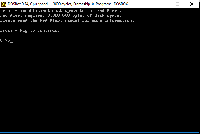

And no freesize is not compatible with -t cdrom. A CD-Rom CANNOT have free space (meaning disk space to write to).

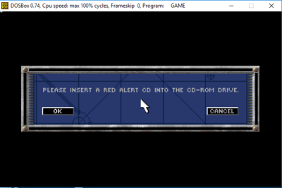

It says= Command and Conquer, it successfully launches but straight to a "insert a disk now" screen when I mount the drive normally without -freesize or -t cdrom

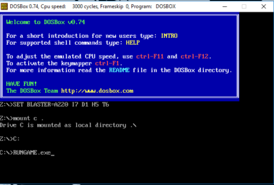

Yes I mounted the folder that contains the launch files, and the folder also contains Dos-box.
Pictures are attached of what happens when I mount the drive.

If I mount the drive normally and launch the game, it asks me to insert a disk
If I mount the drive with the -t cdrom then it clears the screen and tells me I need more memory. It then tells me to press any key and I am given back the prompt.

Mount both a "C:" drive and your CD-ROM drive. Al so it is a good idea to not mount the base of your C: drive, instead mount a folder for your C: drive.
Then change to your CD drive and run the installer.

Achtman, do you use actual CDs or ISO images for the game? If you are using CDs you should mount the drives like this:
mount c  <DRIVE:\SOME_FOLDER_ON_YOUR_HARDDRIVE_THAT_IS_NOT_C:>
imgmount D <YOUR_CDROM_DRIVE_LETTER:> -t cdrom -fs iso
For example, if you have or create a "Games" directory on your hard drive C: and have a CD-Rom drive as D:, this results in
mount c  C:\GAMES
imgmount D D: -t cdrom -fs iso
