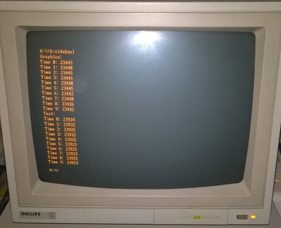

One thing that struck me so far is that the CRTC values for graphics mode and text mode yield slightly different resolutions.
So, I made a small test program to measure the time per frame with the PIT: https://www.dropbox.com/s/lo7p9ravnq0407n/HERCTIME.zip?dl=0
On my system I indeed got different values for graphics and textmode (see attachment).
So I did the maths:
Measured (ATi Small Wonder, 16.257 MHz crystal):
Graphics: ~23440 ticks
Text: ~23923 ticks
Total pixels:
Graphics: 864*370 = 319680
Text: 882*370 = 326340
319680/326340 = 0.97959183673469387755102040816327
23440/23923 = 0.97981022447017514525770179325335
Apparently there is a 2% difference in number of pixels... and also a 2% difference in frame time (which is expected, since the clock is the same, so each pixel takes the same amount of time).
But one thing I am interested in at this point: Original IBM MDA cards have a 16.257 MHz crystal.
My ATi Small Wonder and Paradise PVC4 clones also have a 16.257 MHz crystal.
However, I have images of original Hercules cards online, and they use a 16.000 MHz crystal. I've also seen various clones with a 16.000 MHz crystal. So I would expect those to have slightly longer frame times than mine, because the pixel clock is slower.
If you have a Hercules or clone, could you check which crystal is on there, and/or run my test program and see what values it gives?
    680.09 KiB
    1435 views

Over at VCF, user Xacalite ran my timing program on an original Hercules card (type GB102):
Hercules timing - v1.0c
Graphics:
Time 0: 23842
Time 1: 23839
Time 2: 23843
Time 3: 23842
Time 4: 23843
Time 5: 23840
Time 6: 23843
Time 7: 22809
Time 8: 23842
Time 9: 23842
Text:
Time 0: 24338
Time 1: 24338
Time 2: 24337
Time 3: 24338
Time 4: 24338
Time 5: 24340
Time 6: 24337
Time 7: 24337
Time 8: 24339
Time 9: 24342
This is the result of a 16.000 MHz crystal, as opposed to the 16.257 Mhz one on my clone.
The numbers seem to check out, about 1.5% difference in frame time between the two.
So if one wants to be compatible with a wide range of hardware, one should be flexible enough to handle both timings robustly.

Reply 8 of 9, by Scali
It is correct that there are more active scanlines in MDA mode than in graphics mode.
However, the difference in frame time is not because of this, because graphics mode is compensated for this in the inactive scanlines, both have a total of 370 scanlines per frame.
The difference in timing is because the scanlines are 864 pixels wide in graphics mode, and 882 pixels wide in textmode.
So you can indeed detect which mode you're in by carefully timing a frame. I did not know that there were programs that actually tried to do this though (I wonder what use that would have, aside perhaps from some kind of debugging/overlay tool, where you want to present some additional information on screen, without changing modes).
It is not a very failsafe method however, because nonstandard graphics modes as seen in various games could throw off the timing.
It also doesn't work if you don't 'calibrate' your timer beforehand, by timing both the text and graphics modes, and recording the values. Because as we've seen, there can be different pixel clocks. If you don't know beforehand which of the two you have, you may mistake textmode for graphics mode, because the pixelclock is higher than you assumed.
