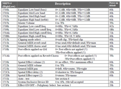

As we all know the DreamBlaster S1 is one cool daughterboard that let us hear MIDI music without trying to find an original board from the 90s or an external synth like Sound Canvas.
Little did I know that the S1 using the General Midi SAM2195 microchip is EXTREMELY tweak-able and has tons of parameters to adjust using NRPN and SysEx messages from a midi file.
It's not just a midi playback device, it's a full synthesizer on a chip.
Have a look at the specifications sheet:
http://serdaco.com/files/SAM2195.pdf
72.39 KiB
2609 views
There are a lot of NRPN and SysEX command the the SAM2195 can receive.
Some of the useful parameters are:
Effects On/Off , to maximize polyphony or to make the S1 dry without effects.
Reverb/Chorus, you can lower the effect of each if you feel it's too much.
4-Band Equalizer, yes we have this too.
Master Volume/Pan.
Clipping Mode Hard/Soft.
I attached a zip file which contains various tweaks to the S1 if you play the midi.
They are S1 hardware specific NRPNs, they will not change even if a reset command of any kind is received.

Very cool!
Setting reverb and chorus is always handy. The X1 does have a jumper which lets you choose between two modes, but this is great for S1 owners.
Now this will set the global reverb and chorus so to speak?
What does the post effects do?
Also when you run a game like Doom that will send a reset, does this cause issues or will the reverb / chorus setting you set via running a midi file prior remain being used?

Reply 2 of 16, by James-F
Not only that, you can choose from 8 Reverb types and 8 Chorus types.
You can also tweak:
Chorus Delay.
Chorus Feedback.
Chorus Rate.
Chorus Depth.
Reverb Time.

Reply 8 of 16, by James-F
No, just like the SC-55 (or any other synth) it will reset to default.
I believe the X1 has the reverb on a separate chip, not part of the main midi chip.
But the Effects-Off command is directly to hardware, so a reset will not change that.
Global. Per Channel. Whatever you like.
Both default global values are 64 (half), like the SC-55.

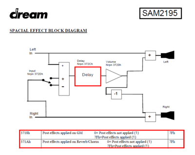

Important EDIT:
I should point that DLY_OFF.MID is not created in vain.
The S1 is a GM only unit so no GS variations or effects, the only effects that are used in any case are Reverb and Chorus, all other effects can not be reached by the GM standard or the SC-55 for that matter, no Delay or EQ are present prior to the SC-88 and are not used in any game or GM music anyway.
The problem is the redundant Delay processing will greatly distort the S1 and have no effect whatsoever just distortion.
Disabling the Delay processing using DLY_OFF.MID actually makes the S1 sound crystal clear and distortion free.
I do not know why the S1 (SAM2195) enables the Delay processing by default or why it is distorted so much, but I think it should be disabled for normal use.
Here is a block diagram with the NRPN commands to disable the post processing that I used:
32.2 KiB
2384 views
Recordings of Descent 2:
S1 Default.mp3
951.83 KiB
119 downloads
EFCT_ON.MID (Default).
The sound is greatly distorted.
S1 Delay Off.mp3
951.83 KiB
115 downloads
DLY_OFF.MID
Only Reverb and Chorus, as it should be for a GM synth.
S1 Dry.mp3
951.83 KiB
118 downloads
EFCT_OFF.MID
Reverb, Chorus, Delay and EQ are Off.

Fascinating topic! Will definitely try it.
Hm, I haven't noticed the distortion. Then again, I'm currently running it on pretty crappy speakers. Judging from your samples, the difference should be immediately apparent.
