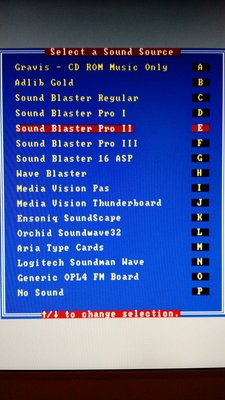

Reply 2 of 19, by clueless1
Well, they have a SB 16 ASP listed separately, so I'm not sure that's what they mean. Screenshot:
288.15 KiB
3199 views
Reply 3 of 19, by Robin4
Maybe this:
Soundblaster Pro 1 - Dual OPL2
Soundblaster PRo 2 - OPL3
Soundblaster PRO 3 - OPL4 (guess its for SB compatible card with OPL4?
Reply 4 of 19, by PhilsComputerLab
I think it was just an option for SB Pro compatible cards. If option II didn't work, try option III. That sort of thing.
Other installers called it "SB Pro compatible" or something like that.

Then why list a Generic OPL4 FM board separately from this?

Reply 10 of 19, by PhilsComputerLab
Are there individual driver files in the game folder?
Something else you can do is try out all the drivers. Does your sound card work with all 3 SB Pro options?
Does it work with the OPL4 option? That can give you more clues.

Good tip, Phil. No visible sound driver files, but the sound.ini file has clues. Looks like SBProII and SBProIII are using the same drivers, just different card ID:

[StartRecord]
; This is correct RT
[CardName] [Sound Blaster Pro II]
[CardId] 115
[CardGroup] 1
[RmMidiDriverName] [sbp2fm.adv]
[RmDigitalDriverName] [sbpdig.adv]
[PmMidiDriverName] [a32sp2fm.dll]
[PmDigitalDriverName] [a32sbpdg.dll]
[MidiDriverChunkNumber] 11
[DigitalDriverChunkNumber] 8
[NumberOfMidiAddresses] 2
[MidiAddress] 0x220
[MidiAltAddress] 0x240
[NumberOfDigitalAddresses] 2
[DigitalAddress] 0x220
[DigitalAltAddress] 0x240
[NumberOfIrqs] 4
[Irq] 5
[AltIrq] 2
[AltIrq] 7
[AltIrq] 10
[NumberOfMidiIrqs] 4
[MidiIrq] 5
[MidiAltIrq] 2
[MidiAltIrq] 7
[MidiAltIrq] 10
[NumberOfDmas] 3
[Dma] 1
[AltDma] 0
[AltDma] 3
[Flags] 1 ; number of flags to follow
[DspEnabled]
[Jumpers] 3
[AddressJumper]
[IrqJumper]
[DmaJumper]
[EndRecord]
[StartRecord]
[CardName] [Sound Blaster Pro III]
[CardId] 123
[CardGroup] 1
[MidiAddress] 0x220
[NumberOfIrqs] 4
[Irq] 5
[AltIrq] 2
[AltIrq] 7
[AltIrq] 10
[MidiIrq] 5
[MidiAltIrq] 2
[MidiAltIrq] 7
[MidiAltIrq] 10
[NumberOfDmas] 3
[Dma] 1
[AltDma] 0
[AltDma] 3
[DspEnabled]
[Jumpers] 3
[AddressJumper]
[IrqJumper]
[DmaJumper]
[EndRecord]
