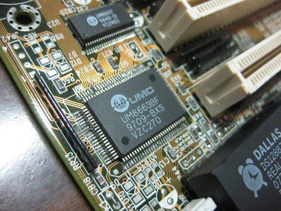

Update : I have a missing Component, CB18 near UM8663BF.
It was broken when I got the board.
I cannot find what would go there. The other CB's on the board act like a Diode when I probe them on board.
I tried to put a very small wire, like a fuse, but the computer won't boot.
It's connected to one of the pin of the UMC chip. There is 4 volts going on this line.
I suspect this component to be the cause of my floppy and COM problems.

I'm not sure what CB18 is for. CX, where X is an integer, usually refers to capacitor. Not sure about the B, nor CB. All my boards have this component, that is, the original board revision, early 2.0 boards, late 2.0 boards, 3.0 board, and v3.1 board all have this component. Try using a non-intel style EEPROM. Also, ensure to set the EEPROM jumper voltage (EPROM, or 12 V EEPROM-intel, or 5 V EEPROM-SST+others).
EDIT: I have measured CB18 out of circuit. It is a capacitor and measured 105 nF.

Reply 12 of 42, by feipoa
If CB is circuit breaker, then perhaps it is just a fuse. I have used SMD fuses of this size in designs before. But I thought fuses were labelled F. You could try to short the solder pads where CB is and see if it fixes things.
If that fails, try ordering some UM8663BF chips. Some boards had UM8663AF chips. I am not sure what the difference was. Newer boards 486 boards, like those produced from 1997 often contain UM8670F. Size and pin-count are the same as UM8663, but not sure what changes were made. I have not seen UM8670F on 8433UUD boards though. I have all these bare components in stock but haven't had time to fix my supply of partially defective motherboards. It shouldn't be too difficult to cut off the old ones and solder on the new ICs.
Reply 13 of 42, by feipoa
When I ran my multi-meter across CB18 I did not get a short, so this component is not a fuse. In which case, do not bridge the contacts with a wire. I suspect the component is a capacitor, but it would need to be removed from the circuit to measure it properly.

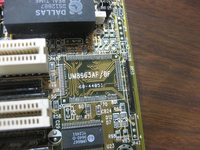

Reply 16 of 42, by feipoa
I removed a UM8663BF Super I/O IC from a revision 3.1 Biostar MB-8433UUD motherboard. The silkscreen shows UM8663AF/BF, so perhaps you can use either of these. This particular MB had a defective floppy controller, so I am hoping the replacement fixes the issue.
The solder-on is a little messy, which I expected because this is the first time I've soldered on an IC with such tight spacing with a hand soldering iron. When you cut the IC off, it is best to cut it off as close to the top of the IC as possible as this will reduce the risk of damaging the solder pads. Also, when you clean up the cut-ends, leave a little solder on the pads, but try to flatten the solder the best you can.

Reply 17 of 42, by feipoa
After replacing the UM8663BF IC, the onboard floppy controller remains non-functional. However, in my case, the BIOS still shows A:\ as 1.44MB 3 1/4" floppy drive. Anyway, I am left wondering which component, IC, or connection is causing this problem. The worst case scenerio would be something wrong with the southbridge chipset, which communicates with the Super I/O (UM8663).
I remember when the floppy controller on this MB suddenly died. I had the system on 24/7 with a 5 month uptime. There was no obvious sign of trouble until an NT4 BSOD message appeared. After that, the floppy controller didn't work. This happened more than 5 years ago.
There is a workaround for this problem, it is to use an ISA I/O card, preferably one with the same UM8663 Super I/O chips. On the ISA I/O card, I disable all features except for the floppy controller (via jumpers). In the motherboard's BIOS, it is important to leave the onboard FDC set to enabled and A:\ to 1.44 MB, 3 1/4" drive, and to ensure floppy seek at boot is disabled. Then connect your floppy drive to the ISA card's floppy header. It should work fine. It is still ugly to have to use an extra ISA card for this though. I would prefer to find the source of the problem.
I have some 4DPS motherboards which also cannot read from the floppy drive via the onboard floppy controller. I have spare Winbond Super I/O chips for these boards, but I am afraid that replacing them might be fruitless inlight of my recent findings. Anyone have any ideas where to start tackling this problem?
