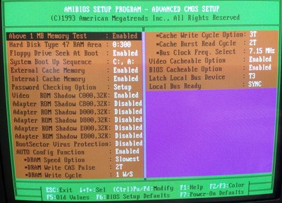

Reply 10 of 17, by clueless1
I was under the impression that with faster RAM, you could be more aggressive with your memory settings in the BIOS:
456.62 KiB
786 views
So, the DRAM Speed Option, Write CAS Pulse, Write Cycle, etc.

Reply 12 of 17, by firage
FPM preceded EDO. They're all types of DRAM.
FPM chips were made as low as 50ns and even 45ns, but SIMM's under 60ns are very rare. 50ns is a lot more common in EDO SIMM's, but those came out in the latter half of the 90's and they're incompatible with many older memory controllers. 486 mobo's also don't usually give options to take advantage of fast memory, unless you're really cranking up the bus.
