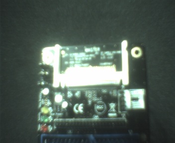

PS: I've attached a photo of one of my CF adapters for you guys, because this model has the pin-20 feature.
But don't get me wrong, I don't post that pic "to show it off". 😅 In fact, I got it by accident and I'm not proud of it whatsoever.
I mainly use this thing for testing purposes only ('cause it has DMA lines and build quality is okey-dokey).
For my eletronics projects I use several types, even the simplest ones (those without DMA are fine for older DOS machines).
    22.92 KiB
    4557 views
    IDE CompactFlash adapter (DeLOCK branded)
    3.3v on-board voltage regulator (switchable), 40+44pin connector, master/slave jumper,
    LEDs for power/activity/master present (LED for 'slave present' can be added),
    DMA capable, power via pin20 (optional), 6.3cm x 7cm
