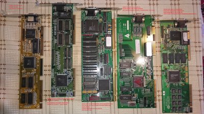

Well, I have been having this itch to build out a fully populated VLB machine for a long tome... and now I succeeded.
The goal was to build a fast 486 with a DX4 or AMD 5x86 CPU and 3 Vesa Local Bus cards, preferably operating at 0 WS, all memory/cache timings set to the tightest possible values.
I have tested this system for a couple of hours and have not met any issues. This, at least, proves that a solid, fast 3-VLB system can be built without major compromises.
I am currenty testing 40 Mhz operation (it might require introducing wait states) but am already content with this within-specs system 😀

- currently: a Cirrus GD-5429 VGA card
    3.36 MiB
    1630 views
    These VGA cards were tested, the 2nd was chosen (Cirrus GD-5429)

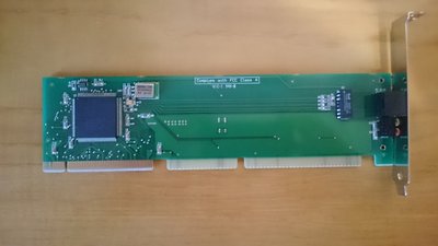

    2.73 MiB
    1630 views

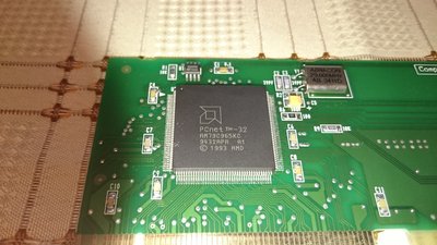

    BocaLAN PCNET NIC
    3.13 MiB
    1630 views

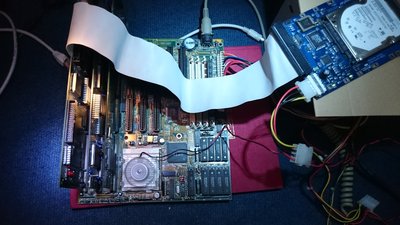

    3.37 MiB
    1630 views
    Adaptec AHA-2842A SCSI card with the DinoMonster adapter
    3.05 MiB
    1630 views

Reply 9 of 21, by matze79
is it only a 10mbit vesa local bus Card ? it doesnt not seem to have any advantage over ISA Cards.
My 3Com Etherlink III is also be able to push nearly 0,9Mbyte/s in both directions/full duplex 10M.
Reply 10 of 21, by Jolaes76
No, AFAIK the BocaLAN card is a true 32bit, 100 mbit card. It is another question whether its beta DOS packet driver is a good baseline for testing or I should run Windows
It just happened that the other computer able to run mTCP has a 10mbit NIC only, and is also only operating at 25x2 Mhz, running the ISA bus under 7.xxx Mhz. So I need a better machine on the other end of as well.

Reply 11 of 21, by NJRoadfan
The PCNet-32 chips is only 10BaseT. I wouldn't be surprised if performance is no better than an ISA card. VLBus network cards were never popular and I think the BocaLAN was the only one ever made. If you want decent Ethernet on a 486, go EISA or PCI. You get proper bus mastering and 10/100Mbit support with either one.
