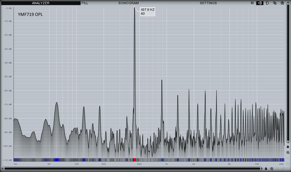

YMF71x
Signal to Noise Ratio: 71db (-89db RMS noise floor, -17.7 Peak signal before clipping).
Working MPU-401 without hanging note bug.
Perfect sounding OPL3 exactly like the original YMF262.

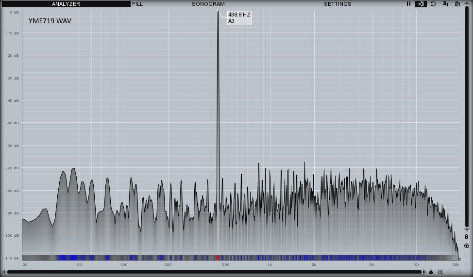

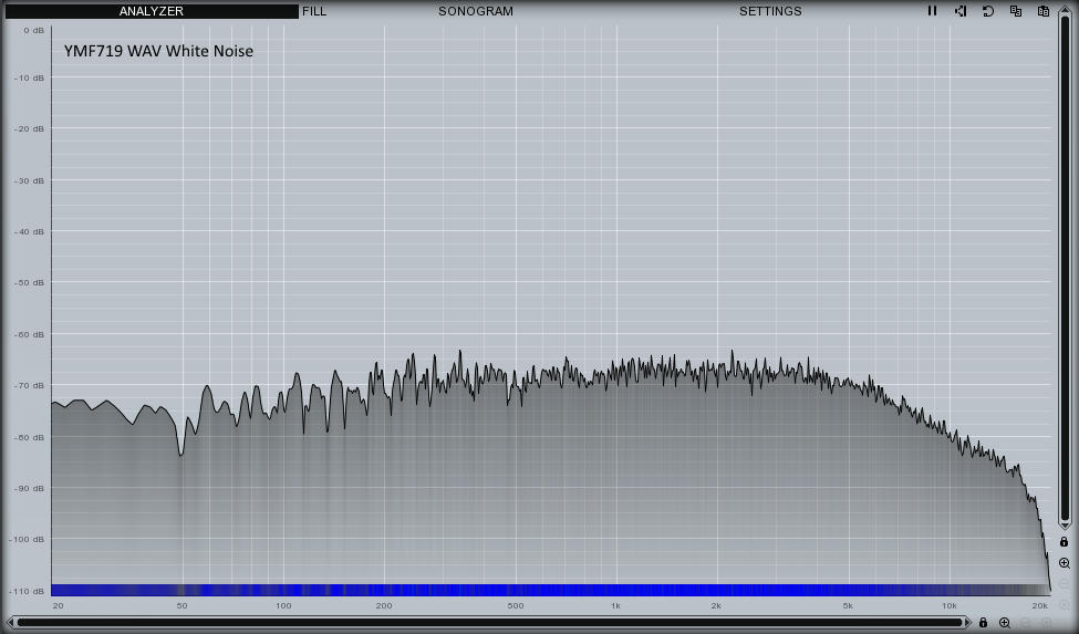

Very clean and low distortion wave output without lowpass filter which may sound harsh.
EDIT: It can be modified to enable the Lowpass Filter like on the SBPro : HERE.
Faulty 8-bit to 3-bit or 8-bit to 2-bit ADPCM capabilities, therefor games like Duke Nukem II has missing sounds.
Has slightly lower pitch (0.5% deviation, inaudible) for OPL and WAV playback, as you can see from the 440Hz images.
Flat White Noise, Lowpass Filter:
440Hz Wav, Harmonic Distortion, and Noise Floor:
440Hz OPL, Harmonic Distortion, and Noise Floor:

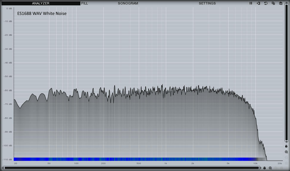

ES1688
Signal to Noise Ratio: 71db (-81db RMS noise floor, -9.7 Peak signal before clipping) [strangely, exactly like YMF71x].
Working MPU-401 without hanging note bug (has to be enabled with a driver).
Working 8-bit to 3-bit or 8-bit to 2-bit ADPCM capabilities, all sounds in Duke 2 work fine.
Non-PNP, simply works with the SET BLASTER command but no MPU-401 without driver.

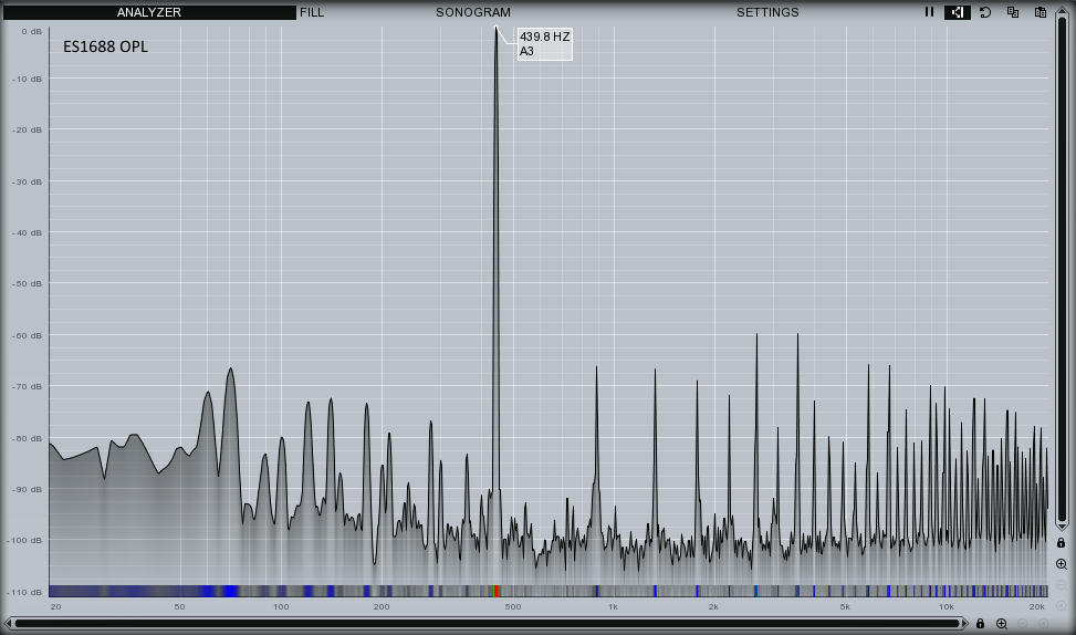

Great sounding OPL3 (ESFM) but slightly different on certain instrument to YMF71x/YMF262 (listen to Stunts track).

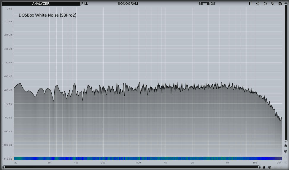

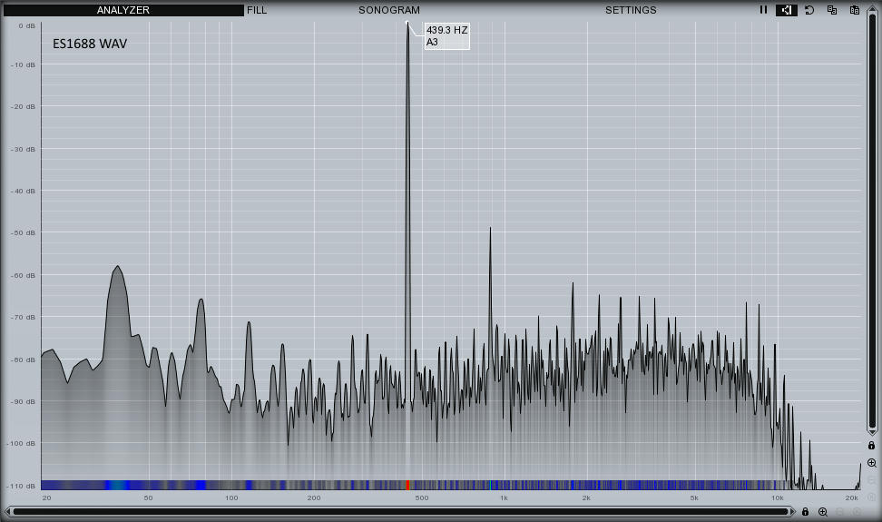

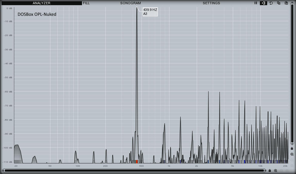

DOSBox

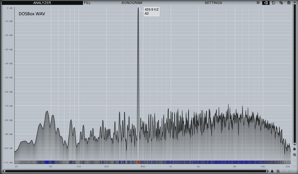

The Lowpass Filter seems to be exactly like on the SB16 cards, dynamically switching with sampling rate, which is a great feature to have.

Attached are the most significant difference between the ES1688 and YMF719 OPL starting at second 00:08.
The reason explained further down the thread.

This is actually important to have a brickwall filter at the niquist frequency (half the sampling rate) to eliminate aliasing.
CD and sound cards at 44.1Khz have a brick wall filter at 20Khz to 22Kz to eliminate aliasing, it is no different on a 22Khz cards like the SB.
The SB-Pro2 has a 22Khz sampling rate in DOS and the brickwall 10Khz lowpass filter has a scientific reason behind it, plus the major nostalgic value of the games sounding just like they used to.

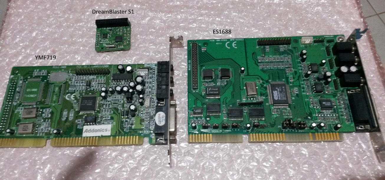

Reply 6 of 38, by PhilsComputerLab
Sweet. Badmojo has already documented a few of the ESS cards. I'll have a look at mine at home and test it when I get around. Once I've done all the Super Socket 7 videos, I can do DOS type videos for a while so that should come in handy.
These are the two ESS cards I have:
YouTube, Facebook, Website

Reply 8 of 38, by James-F
Phil, the second one has a dry leaf on the PCB, some say it's a crucial component to the fantastic sound of that card. 😁

The ES1688 has more raw/gritty OPL3 sound on a particular waveform (which I definitely like), it stays in my MMX build because the more compatible SB-Pro2 emulation with proper lowpass filter.
