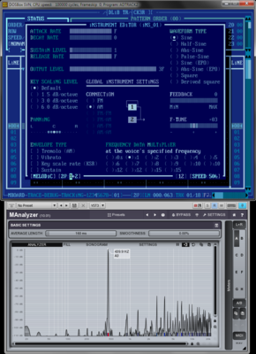

Reply 8 of 44, by James-F
Yep, Adlib Tracker confirms.
I can generate the exact same signal using the AM connection with sinewave on each operator at full volume.
186.68 KiB
4054 views
But I still need the SB2 recordings to accomplish something for the good of all dos gamers. 😎

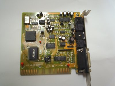

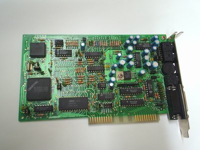

Hello, everone. I've done some recordings for you.
I have used sound cards from my own little collection. They all work, but are also quite old.
Perhaps some caps need to to replaced to restore former sound quality.
    91.57 KiB
    3844 views
    Aztech V2.3A
    aztech.ogg
    258.01 KiB
    125 downloads

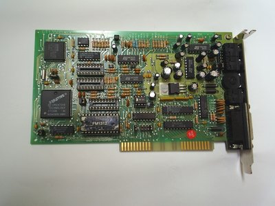

    121.58 KiB
    3844 views
    Creative SB 2.0, CT1350B REV 4 (recapped)
    ct1350b_rev4_recap.ogg
    260.48 KiB
    125 downloads

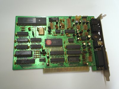

    126.95 KiB
    3840 views
    QuickShot SoundMachine, SB 2.0 clone card, DSP 2.02/CT1336A, 1992
    soundmachine.ogg
    282.39 KiB
    133 downloads

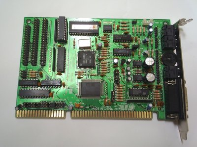

    120.83 KiB
    3840 views
    Unknown Sound Blaster clone, SC801 FM, FCC ID: J4UAV202P3
    sbclone.ogg
    293.59 KiB
    118 downloads

Finally! This is great, thank you Jo22!
Question,
Is it the recordings of the following?:
OPL440.com
MPXPLAY.EXE + 440_0db.wav
What is first, what is second?
Reply 15 of 44, by Jo22
Hi, there! Glad I could help! 😀
Yes, FM first, then the wave sample.

Few more cards? This would be great!
The Aztech and the Clone have some serious distortion in the WAV sample, but the Creative and QuickShot are clean.
I am going to produce DOSBox FM to SB level matching ASAP.
EDIT:
There is exactly 8.5db difference between FM and WAV on both Creative and QuickShot cards.
To recreate that in dosbox with Nuked-OPL, FM should be set to 75, not 100.
The following command should recreate a perfect balance between FM and PCM in DOSBox with Nuked-OPL patch.
mixer fm 75

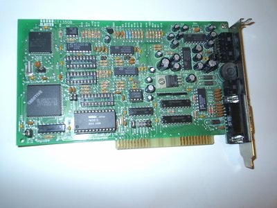

    131.09 KiB
    3796 views
    Creative SB 2.0, "SOUND BLASTER CT1350B", DSP v2.02, CT1336A
    ct1350b_new.ogg
    288.58 KiB
    129 downloads

The SB 2.0_new has exactly 8.5db difference like the previous you posted, and they both sound and measure very clear.
The QuickShot SoundMachine looks like an exact replica of the Creative and sound like one, great card.
