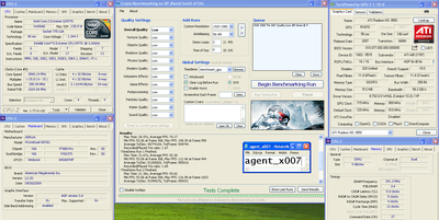

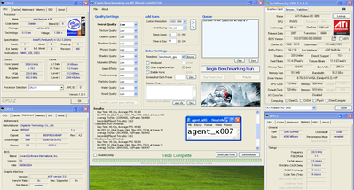

Reply 8 of 23, by agent_x007
Jade Falcon wrote:
Good luck. You got the gpu but a p4 will be pushing it.
Have some faith 😀
Netburst isn't that bad 😁
298.08 KiB
1583 views
P4EE @ 3,53GHz manages to use around half of HD 3850's performance there :
305.45 KiB
1580 views
Which is OK in my book (considering all things 😉).
