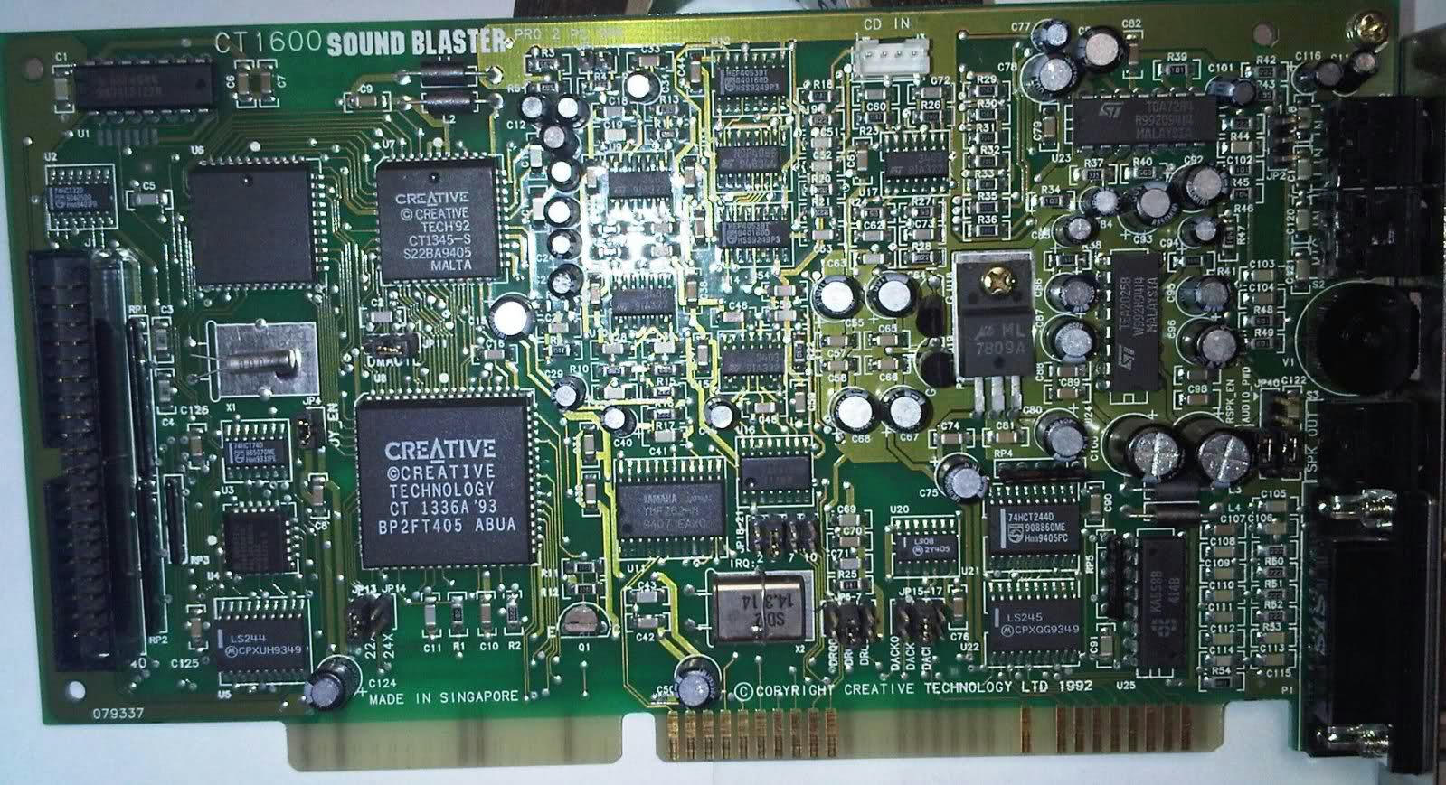

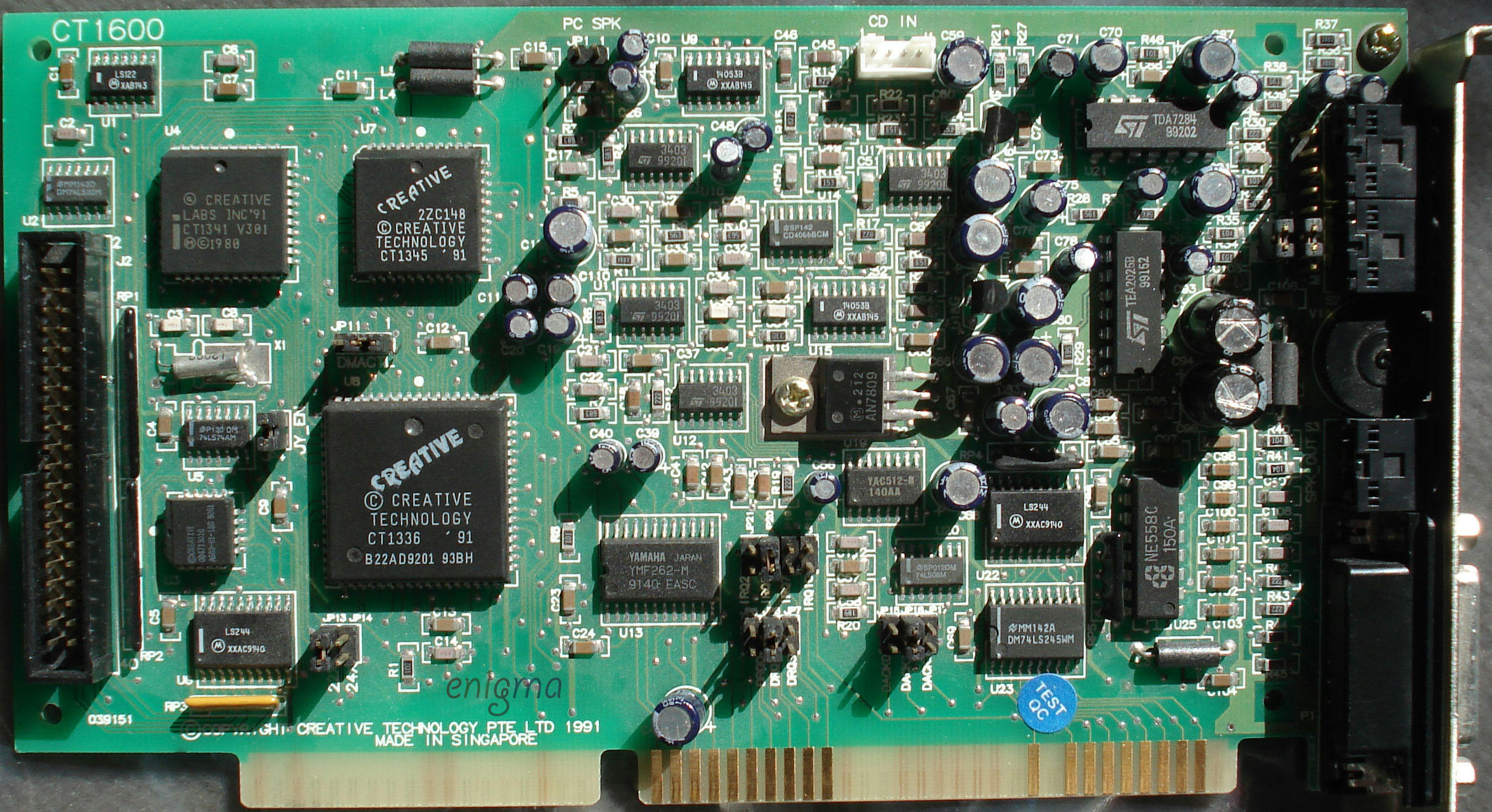

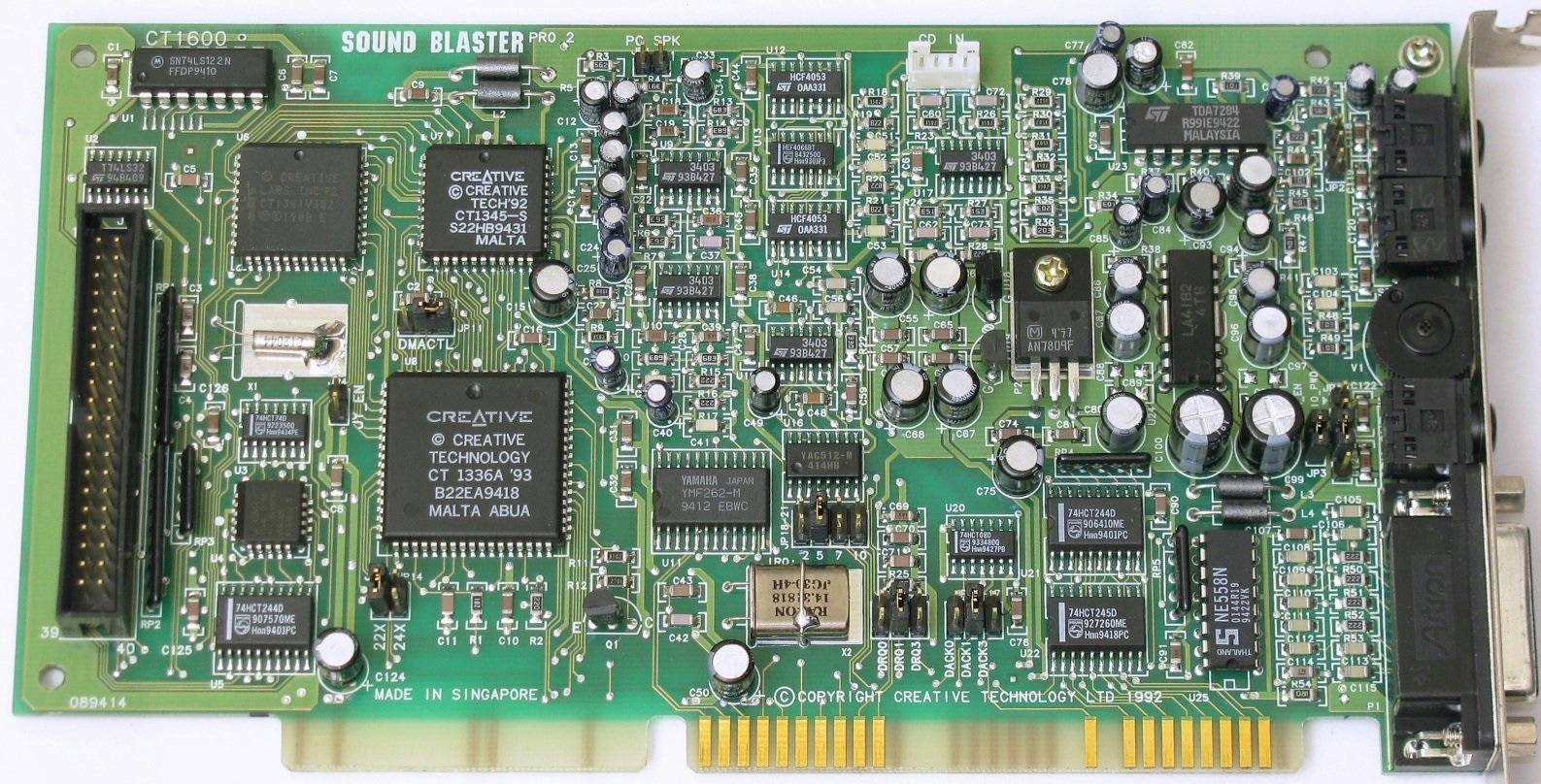

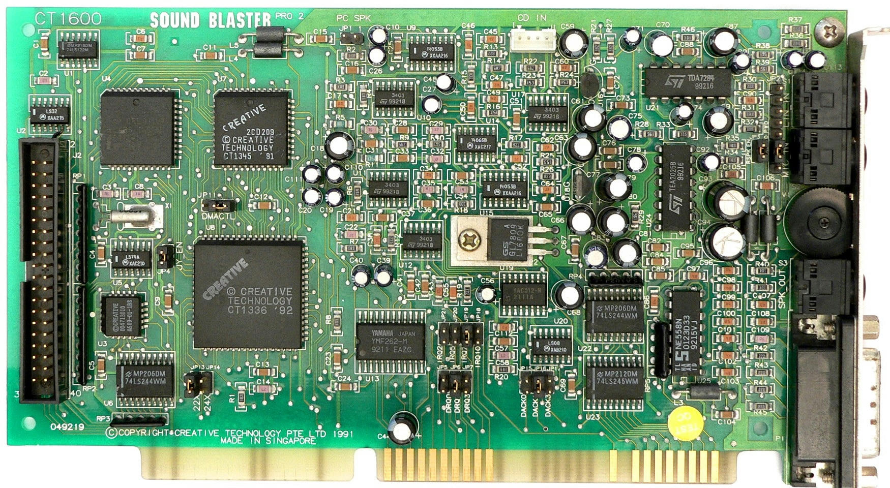

I want to make a small list and pictures of the SBPro2 CT1600 revisions and differences between the revisions.
Currently I have found on google images 6 iterations of the the same CT1600 card with revision numbers beginning in 03, 04, 05, 06, 07 and 08 at the left bottom of the cards.
Images: 03, 04, 05, 06, 07, 08.
From revision 05 (now marked 1992) a 14.318Mhz oscillator chip was added on board, previous revisions took the clock from the motherboard(?).
From revision 06 the Bus Interface chip changed to CT1336A from CT1336.
From revision 07 I can see a different mixer chip CT1345-S instead of CT1345.
I would like to know more about the revision changes of the SBPro2 CT1600 cards and if there are major sound differences.

Reply 5 of 106, by firage
03->04 branding
04->05 oscillator for OPL
05->06 LS122 in bigger DIP packaging
06->07 major redesign
07->08 moved the model number
That's what jumps out at me.
Would be interesting to compare pre-07 and the revised layout in some detail.
