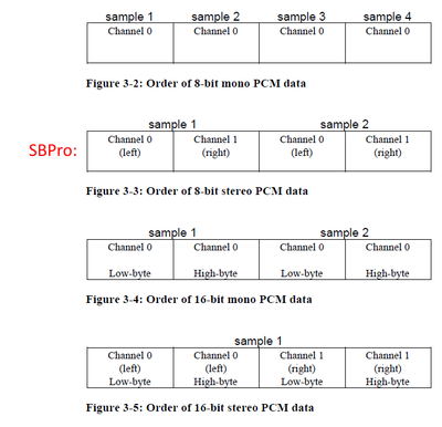

The SBPro plays stereo by interleaving the left and right bytes, and it is thought that the CT1330A behaves differently that the CT1600, this is what we trying to figure here.

If I'm not mistaken, SBTEST.EXE plays a sinus wave only on the left channel, which according to the sound blaster programming guide should be only ODD samples 1,3,5,7 which go to the LEFT channel on the first test.
On the second test it inserts extra byte before playing the PCM sinus resulting in the sinus first sample starting to play on the second EVEN sample thus reversing the Stereo.
This is not the case with the SBPro2 which always starts new PCM stream from the first sample, no matter on what sample the previous stream ended.
Most SBPro2 clone cards I've tested reverse the channels with the extra byte, thus making Quake sound reversed....
It is believed that the SBPro1 CT1330A ignored the first sample and starts to play the left channel on the second sample which resulted in reversed stereo.
