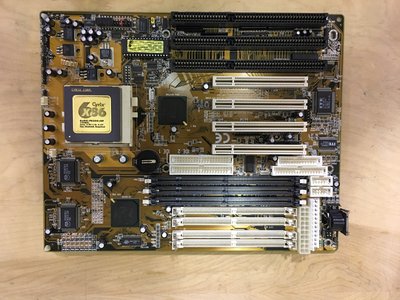

Well I'm kinda fed up with some of the Super Socket 7 stuff for now so, how about a standard Socket 7...
I dug through a lot of stuff and found this. A bit of Googling and I think it is a Shuttle Hot 569 ver. 1.2 TX motherboard.
2.61 MiB
684 views
What do you think? Pentium 233MMX, 64MB RAM, some video card(s), some sound card(s) and play some games!
I never built an AT box before so it should be fun.

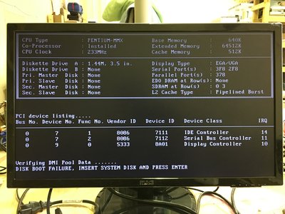

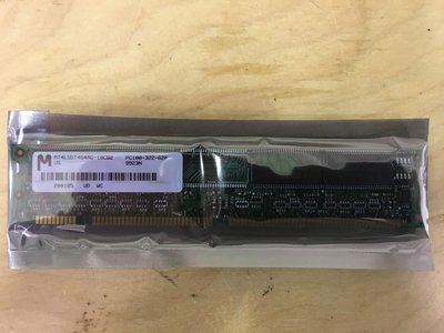

Installed a Pentium 233MMX CPU and set jumpers
Found two new Micron 32MB DIMMs! Yay 64MB RAM installed done. (You'd be surprised at how much stuff I have in my shop, 🤣)

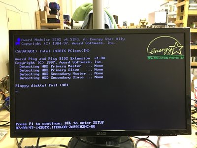

Reply 5 of 13, by squareguy
Installed S3 Virge\GX 4MB video card
It Lives!

Reply 6 of 13, by squareguy
Found a BIOS update and installed. Can now support 128GB hard drives.
569WIQ0E

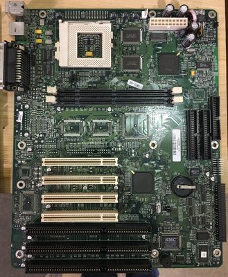

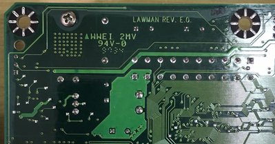

Why oh why.... all my plans, I keep getting sidetracked.
Intel / Gateway Lawman Motherboard. Intel 430TX chipset, don't know much else at the moment.
885.77 KiB
437 views
3.53 MiB
437 views
Oh no! They're Twins!
2.62 MiB
437 views
Both boards built late 1997
