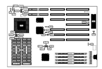

So I had a chance to go to my parent's place and pick up my only socket 4 CPU, and fired up the VIP596P3 board I got from a flea market a couple of weeks ago - and it works! (sort of). The board posts, and I've been able to run speedsys, 3dbench and PCP bench. It performs like a 133MHz AMD 586 in these tests... so... I tried running Quake... problem is I get a "Page Fault at eip=000c928" bla bla error when it's loading the timedemo. As far as I can tell this is memory related...
Thing is, I haven't been able to correctly identify the board. I tought it was made by QDI, but the QDI model is called V5P596P2 and is slightly different - it only had 2 VLB slots, less jumpers and some of the jumpers aren't in the same place as on this board. Here is the stason.org page for the QDI board: http://stason.org/TULARC/pc/motherboards/Q/QD … PENTIUM-VL.html
The attachment qdi.png is no longer available
As you can see it's slightly different - enough so that half of the jumper settings don't match.
Getting to the point - does anyone have a manual for this board? Do you have any idea who made it? Is it possible it's made by QDI but is a different model? What could be causing quake to crash?

well this board is either extremely rare or part of a specialized machine, because that's the only links google will show...
Reply 3 of 30, by brostenen
I noticed that too. Hmmm..... I did not see much more than that by googling "motherboard vip596P3"
Reply 4 of 30, by kanecvr
It's posible it's rev 2.0 of V5P596P2. I figured out witch jumpers set the FSB, so I'm now able to set the thing to as low as 20MHz or as high as 75MHz (not stable at 75, won't boot) 😀 I think I can get 286 speeds out of it at 20MHz with cache disabled - but I'm having some issues with L2 cache. It's a great board for simulating a 486 with a fat FPU or a 63MHz socket 3 POD 😀
The thing is I remember there were 2 versions of the socket 4 pentium - one running at 5v and one running at some other voltage 5.2 or 5.4v - as such I need to find witch jumper sets that...

I actually have a couple of issues with the board. First, I can't seem to be able to get EMM386 to run. Regardless of what I try, i get "Insufficient Memory, emm386 not loaded". The second is artefacting in 640x480@16 bit with any video card I try, PCI or VLB. It seems to be worse for VLB since these artefact at 640x400@256 col. I eliminated all possible software causes, all that's left is the hardware.
Reply 11 of 30, by FGB
- Do you have the jumpers set to 1 WS for the VLB?
- The board should have options for the source of the clocks. External or internal via dividers. I recommend to set the clocks for the PCI / VESA Bus to external, it will use one of the 33MHz crystals to generate the clocks.
- There should be also a jumper for BACK TO BACK IO DELAY. I recommend it to set it to "ENABLED".
- Try to test without cache. These boards are sensitive and highly rely on cache stability to perform.
- Did you always close the turbo SW? My manual says: "if you use EMM386.EXE, the system will not allowd to enter non-turbo mode" - However, the statement may only be true for the specific board (MB-5DVP)
- I can provide another BIOS, you can flash and try.

I only have approximate jumper settings for the board... no proper manual or jumper settings anyware so I can't really set anything up 🙁
Yup. Tested with cache disabled and I get the same error and video artifacts. Also tested with 128 and 512kb of cache, 8kb and 16kb TAG, as well as completly replacing ALL cache chips with known working ones.
I did not. But I don't think it has a turbo switch.
If it's for my board, then by all means, thank you.
So far I've been able to ID the following jumper settings:
JP6 1-2 8kb TAG RAM | 2-3 16kb TAG RAM
64kb Cache - JP21 open | JP20 open| JP19 open
128kb Cache - JP21 closed | JP20 open| JP19 open
256kb Cache - JP21 closed | JP20 closed | JP19 open
512kb Cache - JP21 closed | JP20 closed | JP19 closed
Cache uses banks 0 only JP22 2-3 | JP23 2-3
Cache uses bank 0 only with 256k cache - JP22 2-3 | JP23 1-2
Cache uses both banks JP22 1-2 | JP23 1-2
CPU Speed:
75MHZ - JP24 closed | JP25 closed| JP26 open
66MHZ - JP24 closed | JP25 open | JP26 closed
60MHZ - JP24 open | JP25 closed | JP26 open
40MHZ - JP24 open | JP25 closed| JP26 closed
20MHZ - JP24 open | JP25 open | JP26 open

I have memory and cache timings in BIOS. Also PCI level/edge and irq settings. The only thing I haven't tried is setting PCI IRQ to "Level" instead of "Edge".
BTW, the thing score 49 pts in speedsys - that's as much as a 133MHz 486 - is that normal?
FGB wrote:
I bet your board has a Turbo switch.
I've studied the PCB quite a bit and found no possible trace of a tb switch header. There's a high-res photo in the first post - look it over yourself. It would be cool if this was the issue.
Reply 17 of 30, by FGB
49-50 points are normal for a Pentium @66MHz. But of course SpeedSys doesn't reflect real world CPU performance in its CPU scores (For example, a 386 without FPU scores much higher in Speedsys than a 386 at the same speed with a FPU installed.)
Will take a look at the picture later, maybe we find that pin header. //edit: Can't find one.

VIP596P3 i think that mean its having 3 VLB slots on the board
VIP596P2 this saying it having 2 VLB slots on the board.
REV is just the reference design version number of the board.. This means a higher number is a changed motherboard design.
Reply 19 of 30, by kanecvr
Robin4 wrote:
VIP596P3 i think that mean its having 3 VLB slots on the board […]
Some jumpers are missing on my board - completly - not even the pads. JP4, JP5, JP7 for selecting internal or external clock for example... FGB stated that I might get better stability by selecting external clock, but it seems I can't since the jumpers for it are missing... Also, jumper layout is slightly different. The only jumpers that are where they are supposed to be are half of the cache selection jumpers and the VLB WS jumpers.
