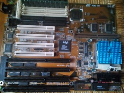

I bought a few month ago a "PCI-P54C-TR4" motherboard which seems to be a neat motherboard (HX chipset, etc). However due to bad computer builder (I had it with it's AT tray), it was bent for years. I wanted to use it, but it started to crash randomly (sometimes it didn't POST). Now that I have a POST card, I can know exactly when it crashes. By applying pressure on different parts of the board when it doesn't want to work allows it to POST normally and even boot for a little while, but it's not something that is really durable ...
So is there a way to repair it ? I'd like so munch to be able to do that because as I said, it seems to be a very neat motherboard. I don't think that any components are broken, just the PCB that have been in an incorrect position for way too long

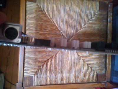

Here are photos of the board

As you can see, it's not bent anymore, but on the tray it came with, it was very curvy here
Also, at some point when I first got it, I made THE mistake with the at psu, I plugged it with the red wires in the middle, but I don't think that it would be that thing that would cause that issue. Why applying pressure would make it work again like a charm ?

Oh I've another problem yet ... The frequency generator seems to be completely broken ... Whatever I set, clock just sets itself to whatever it wants (stuff like 90MHz, 110MHz, 133MHz, 150MHz, 166MHz, even though I set 200MHz, 75MHz, or whatever, it's completely crazy). Here too, when I apply pressure on what seems to be the clock generator, the frequency changes (for example, when it displays 110MHz, when I apply pressure and reboot, it displays 120 or 150 instead).
Very very odd problem.
I thinked about using a heat gun. What do you think about doing that ?

Given the age of these things it wouldn't be surprising if a trace broke when the board went back to its non-bent form after you removed it from the tray. If applying pressure seems to make it work properly then probably that's the culprit. Finding the broken trace is a whole another issue though.
As you say, it doesn't look bent at all now, but some of those old paper-thin taiwanese/chinese boards were probably more susceptible to problems due to bending.

Sounds like an intermittent connection somewhere, in fact it sounds like you may have narrowed down where it might be. Reflowing solder joints anywhere that you find suspicious might help.
