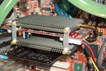

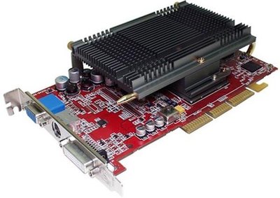

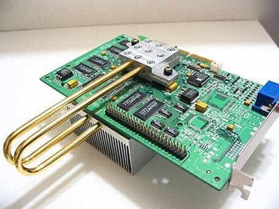

Reply 16 of 23, by amijim
Hello vogons,I am about to install two fanless Zalman zm80c heatsinks in my voodoo 5500.Please stay tuned for the details.

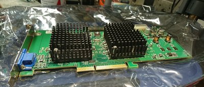

Reply 17 of 23, by Kizmo
413.54 KiB
1822 views
This is my solution for the card i repaired in my repair project thread. Seems to run fine at stock clock. 😀
3DFX - Gone but never forgotten
Reply 18 of 23, by mzry
I like your hestsinks, could you advise where to buy them from and whether the holes had to be manually drilled?
Reply 19 of 23, by Kizmo
These were junk box finds, i think passive coolers for Pentium I cpus of some sorts. I did cut and drill them to fit.
