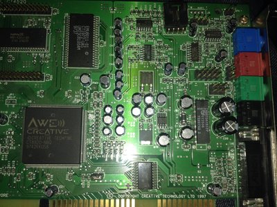

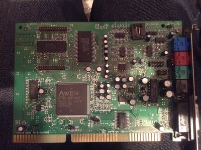

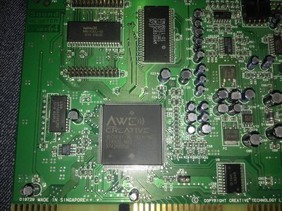

Reply 37 of 104, by Robhalfordfan
dr_st wrote:
1) Am I correct that no matter what you tried and no matter which environment you tested in, you never got any FM or AWE music to play, ever?
2) Can we see a photo of the card?

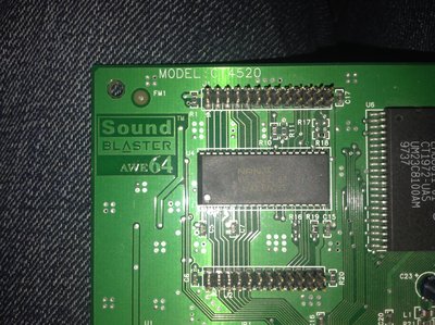

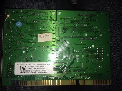

When I run diagnose to see what sound isn't coming out, I get 8-bit and 16-bit sound but no awe wave form or synthesised sound coming out and few pics of card below
    1.32 MiB
    1006 views
    1.85 MiB
    1006 views
    1.69 MiB
    1006 views
    1.5 MiB
    1006 views
    1.42 MiB
    1006 views

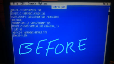

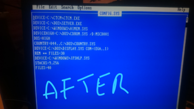

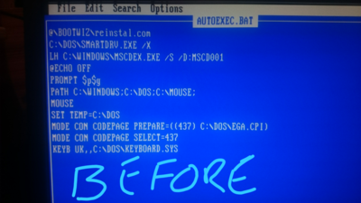

Reply 38 of 104, by Robhalfordfan
gdjacobs wrote:
Doom is able to find the EMU chip? Last thing, run MIXERSET and crank all the inputs.
I'm starting to wonder if we're looking at a broken trace or maybe a blown component.

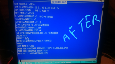

There is pics in last reply for pics of card and here are pics of config and autoexec.bat before and after installing the drivers for sound card
Reply 39 of 104, by dr_st
What's this REINSTAL.COM thing?
You don't need CTCM in CONFIG.SYS.
You don't need DIAGNOSE or CTCU in AUTOEXEC.BAT.
I don't think any of this should hurt, but it definitely does not help, so maybe it's best to take it out.
I would also try with a bare CONFIG/AUTOEXEC (just press F5 to skip both files) and then try to run the sound-related lines of AUTOEXEC manually. Unless it needs HIMEM.SYS? Don't think so, but not sure.
