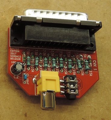

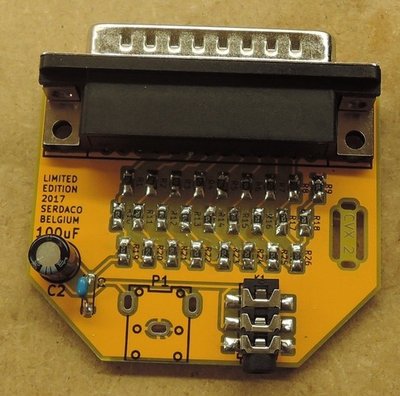

I am testing 2 covox adapter PCB prototypes :
CVX-1 : through hole, 1% resistors (2 different values)
CVX-2 : SMD adapter, 0.1% resistors or 1% resistors (all same value, same batch, for best accuracy)
I have been playing with a low pass filter cap and like your feedback, what sounds best ?
I tested with crystal dream demo on the CVX2 (0.1%) :
10nF ? https://youtu.be/TVaPQ41huBY
100nF ? https://youtu.be/wcqD_SzOz_c
5nF ? https://youtu.be/w8gLaZD46ew (ADDED)
1nF ? https://youtu.be/RaZH5dXw1eY
no cap ? https://youtu.be/bn-spjT_A-A
What do you think sounds best ?
Which other demos / games / music software (that support covox adapter) are recommended to try with the CVX adapters ?

That is a very nice addition to your lineup.
I have a hard time deciding if I like the 10nF or 1nF more. The 100nF sounds very subdued with a lot of high frequencies loss, and the no-cap is a bit too harsh IMHO.

Yea, 100nF is definitely too muffled.
I think 10nF is acceptable. It affects the sound slightly, but it remains bright enough.
The difference between 1nF and no-cap seems negligible.
I think my vote goes to 10nF.

I prefer rougher sound in general.
100nF is way too muffled and as said already, loses many high frequencies.
10nF is a little bit too soft to my personal taste.
1nF sounds right to me.
unfiltered is acceptable to me, but may not be to other ears. So 1nF to me seems to be the balance.

okay, I tested with 5nF (2x10nF in series)
(I'll add the link to the first post)
Is this better than 10nF or 1nF ?

dreamblaster wrote:
okay, I tested with 5nF (2x10nF in series) https://youtu.be/w8gLaZD46ew (I'll add the link to the first post) Is this better tha […]
It's slightly more subtle than the 10nF, but still takes off a bit of the brightness/harshness.
I think 5nF might be the way to go.

Reply 16 of 484, by James-F
I think we are forgetting that the filtering is there to avoid terrible sounding aliasing, just like in the sound blaster cards.
Yes, high value will not sound good with music when compared to how HiFi modern music sounds, BUT to low value will make aliasing very clear in sound effect.
Most of the audio meant to be played on the Covox is 11kHz, thus everything above that is filtered out, again, just like in the SB card.
I think some game with sound and music should be a more fair comparison.
