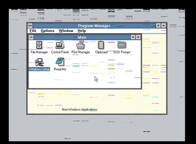

2. Running Windows 3.0 on the 80186 XT configuration (Turbo XT BIOS v3.0) makes Windows 3.0 boot correctly. Then, once displaying the program manager and main group items, the screen gets filled with strange coloured lines and the OS hangs(including the mouse, which responds correctly before the program manager starts up).
97.79 KiB
1266 views
Windows 3.0 on UniPCemu's 80186 XT emulation.

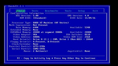

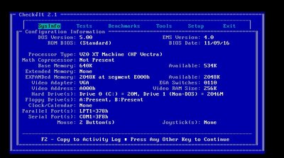

I've ran checkit on all 8 and 16-bit (except 286, which is 16-bit only) bus settings:
145.95 KiB
1266 views
CheckIt Diagnostics XT 8086
145.95 KiB
1266 views

1266 views
CheckIt Diagnostics XT 80186
145.7 KiB
1266 views
CheckIt Diagnostics XT 80188

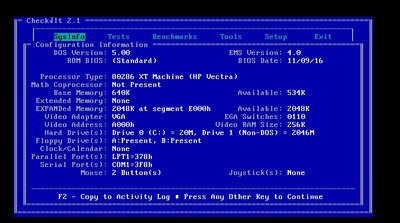

Reply 3 of 69, by superfury
146.08 KiB
1266 views
CheckIt Diagnostics XT 80286
AT 80286 with Turbo XT BIOS v3.0 won't boot (keyboard won't respond and XT-IDE Universal BIOS(AT) hangs directly after Master/Slave detection).
The AT uses 6144KB of RAM, as detected by the AT BIOS. Using the AT BIOS instead of the Turbo XT BIOS on the AT makes the hard disk work correctly again, and boot into MS-DOS(Loaded drivers: Sound Blaster 2.0 drivers, Himem, LT-EMM drivers(doesn't detect)), CuteMouse(Detects mouse at COM1 03F8h/IRQ4 in Microsoft Mouse mode).
