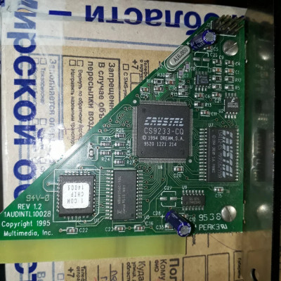

Here's CrystaLake Series 2000 with 8-pin connector. It is a 8-bit ISA card by itself.
Do you actually have that card? I tried to buy one a year or so ago and the seller never shipped it.

cyclone3d wrote on 2020-01-15, 15:34:
Not mine. A person from phantom.sannata.org forums recently bought one: topic (all in Russian)

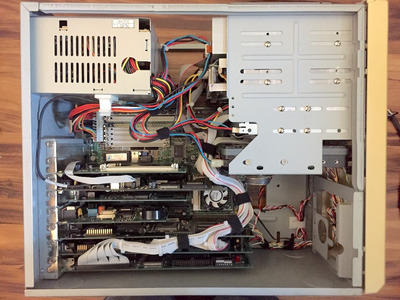

I've never seen a Goldfinch header on an SB16 -- I'm guessing that would have to be an OEM version? I just connected mine via a custom ribbon cable to the wavetable header on an SB16. Works great!
Observe my potato-cam shot:

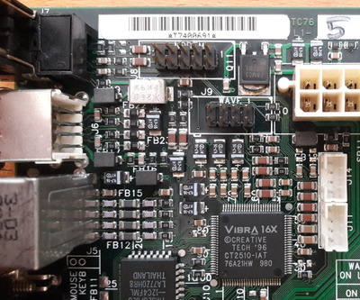

On my recently acquired Tulip TC76 mainboard I found an 8-pin header labeled "WAVE" as well.
See the attached picture.
I think it should be doable to trace back the connections to the Vibra 16X chip with a high-res photo and then figure out whether it is possible to build a simple 8-to-26-pin adapter cable.
1.33 MiB
1210 views
Tulip TC76 onboard sound area
I have done research but apart from this very thread here on Vogons (where else...) I did not find a single hint to this connector, let alone its pinout.
