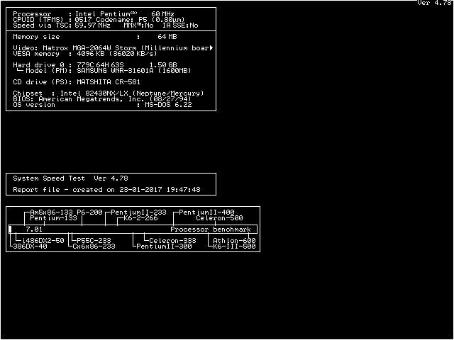

This board seems to have turbo functionality in three ways:
- via the standard turbo_sw pin header;
- via the BIOS option;
- via CTRL ALT +/- shortcut.
Seems like I've connected turbo_sw the wrong way — it doesn't do anything at the moment. Not sure how that's possible, though — it's a three pin header for a triple wire connector.
BIOS option works and speedsys shows that CPU is slowed down to 386@40MHz levels (DOS 6.22 takes a really long time to boot). The manual, however, says that "de-turbo" performance should be at 286@8MHz. Going to make a Wing Commander test soon.

Reply 11 of 25, by jheronimus
melbar wrote:
That's a quite good description in this manual.
Would be very good, if the 386@40 and 286@8 mode really works...
I've tried using Turbo button again. Turns out, it simply doesn't do anything on a working system. If you push the Turbo button and reboot, then you get the performance equivalent to the "de-turbo" option in the BIOS. Would be great to figure out a way to get Turbo mode without rebooting. The manual says the following:
Changing the Turbo mode may be prohibited by an operating system or application software. For example, the CPU speed cannot be changed with the hot keys when the CPU is in Protected Mode.
I also ran some benchmarks:
SpeedSys: 7.01
System Information 8.0: 16.3
PC Player Benchmark: 2.0
3DBench 1.0: 7.2
According to SpeedSys, that should be about the same as 386DX-40. System Information puts turbo performance at half of 386DX-33.
I've tried running WC1 and the weird thing is, it seems perfectly playable. I don't have a real 386 to compare it with. Tried running it in DosBox at 3000 cycles and the speed seems identical. I thought Wing Commander needed a 386-class CPU?
