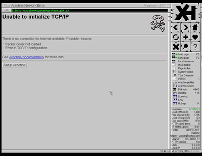

I have problem getting the emulated network card with SLiRP instead of PCAP, the NE2000 ISA on the DTK 486 machine (AMD 486DX2 66MHz, 8 MB RAM, Phoenix S3Trio 64 w/1 MB VRAM).
I installed the Arachne v1.97 and tried to configure the IP address to use 10.0.2.15, 10.0.2.2 for the Gateway and 10.0.2.3 for the DNS as well as Boot/DHCP.
When I select Boot/DHCP, Arachne wouldn't even initalise the TCP/IP at all.
Here's a screenshot of the problem that I've been encountering:
27.14 KiB
6339 views
Network problem...
The guest OS that i have installed is MS-DOS 5 and Windows 3.11 (no workgroup support).
Is there a way how this can be fixed?

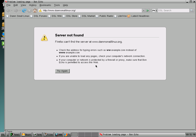

Update: I managed to boot the DSL linux distro off of the ISO on the ASUS P/I-5541P4XE machine and ended up using the Phoexnix S3 Trio 64 card with 2 MB RAM. The machine has the capability to boot off of the emulated CD-ROM.
I used DHCP when I set up the networking and when I tried to access the Damn Small Linux, I wound up getting a Server not found error:
123.27 KiB
6248 views
DSL Bon Echo - Server not found
Any idea what could be wrong when I use Win10Pcap and setting the network type to PCap?
