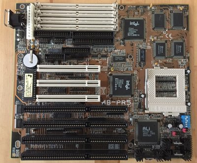

I've found a Socket 7 motherboard, it's an Abit AB-PR5 R2 Rev. 2.41.
Does anyone know if this board can use Pentium MMX or AMD K6 CPUs? The scanty documentation I've found so far only mentions non-MMX Pentiums and AMD K5.
I've seen numerous forums references to people using it with say MMX 200 MHz, but all these threads are at least a decade old. There are also Ebay listings for the board coupled with an MMX CPU, but I'd like to have some solid info.
Anyone have the manual or jumper layout for this specific revision? I've checked in the "usual" places, and only found for other versions of the board and jumpers seem to be different which is confusing.

Reply 2 of 32, by GPA
The VRM section looks quite solid, it might suport dual voltage CPUs. I think what you need to do is grab a multimeter and measure...
Measuring of the voltages:
Socket 7 MessaufbauIf you use a load resitor of 100 Ohm between B16 and A17 in the CPU-Socket (in the pic to the upper right), you can measure the core voltage of 2.2V. At the resistor between B18 and A19 (lower right) one can measure the 3.3V supply voltage. (Don't regard the red and black in the picture, you measure between the ends of your resistor, of course). The third 100 Ohm resistor in the upper left is for switching to dual voltage.
CAUTION: before power on close the Socket! The voltage regulators should not be used without load (empty socket)!
The core voltage can be measured between pin 2 (or the housing of the VR) and ground.
(https://www.ccwn.org/~lgeromil/k6_2_e.html).
On my end i had no issues powering boards with no load (empty socket) but i cannot guarantee it would be fine on any board.
My guess, if there is a configurable VRM, it would be configured using jumpers in lower right section of the board, where the voltage regulator is mounted. One more guess, it probably is the longer row, not the shorter one, although can be either or both (shorter would allow for split voltage, longer would choose between levels). I would play with that while the board is switched on and no CPU is plugged in.
Good luck!
Reply 4 of 32, by Tetrium
Richo wrote:
or you can download the manual:
download location of manual
Even though the board in the manual looks different, it does indicate it supports split voltage down to 2.7v, which should be enough for Pentium MMX chips.

Reply 6 of 32, by c0keb0ttle
Unless I'm looking at the wrong manual, that one shows dip switches for setting VC, which I don't have on my board. It also shows both 72-pin and 128-pin memory slots while my board only has 72-pin.
There seems to be numerous versions of PR5, mine is an R2 rev 2.41.

Reply 12 of 32, by meljor
I could be wrong, but i don't think i've ever seen a 430VX not supporting a mmx.
Reply 13 of 32, by Deksor
I've one 430VX that doesn't support the pentium MMX, at least not directly as there is no way of changing the voltage with jumpers. You can however change it by using a VRM, but this is a bit expensive ...

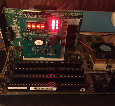

Well, so far so bad:
260.47 KiB
2300 views
No beeps, no error codes.
The CPU and memory works fine with my ASUS board.
Might be a dead motherboard. 🙁

Reply 18 of 32, by c0keb0ttle
Unfortunately it seems like this board is deader than a dodo. 🙁
I've now tried it with a bog standard Pentium 133 MHz CPU and it still refuses to show any signs of life. No POST, not a single beep, no nothing.
How annoying. 🙁
Reply 19 of 32, by gerwin
Some experiences of mine that match a totally dead board:
- BIOS chip not fully inserted / poor contact.
- Voltage Step down chips overheated in the past, solder got loose, therefore the Voltage Regulator Module gives no 'Power-Good' signal to the BIOS.
