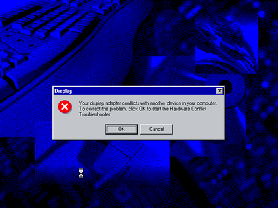

When I was trying to install some video drivers on windows 95 on 86box, I got this. I don't get it, there is no other device I am trying to install. All I saw was a new hardware installing message which was a PCI IDE controller. Is there a way to get over this problem?
If you use this emulator before and installed some video drivers please leave your response.
Thank you.

    Here is the problem that occurred when installing the video drivers.
Reply 1 of 14, by Jo22
Did you install any graphics drivers or did you change the graphics adapter during installation ?
Without any details it's hard to figure out.. 😅
Perhaps this will help: If there are two graphics devices, delete one of them..
- Usually the one that's causing trouble (any yellow marks in device manager ?)
If that doesn't help, remove the correct-named adapter and apply its driver to the generic VGA device.
Sorry, I'm not good at explaining things. 😅

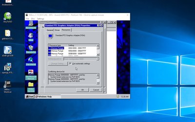

What I found what was conflicting with the device is the System extension board for PNP bios I removed in from the system and rested my VM but when everytime I boot up my windows 95 VM it installs back again.

I think it's because the Virge, there, is using IRQ 3.

When using the Virge or the Nvidia cards, make sure to disable COM 2 (and that COM 1 is not by any chance set to IRQ 3).
