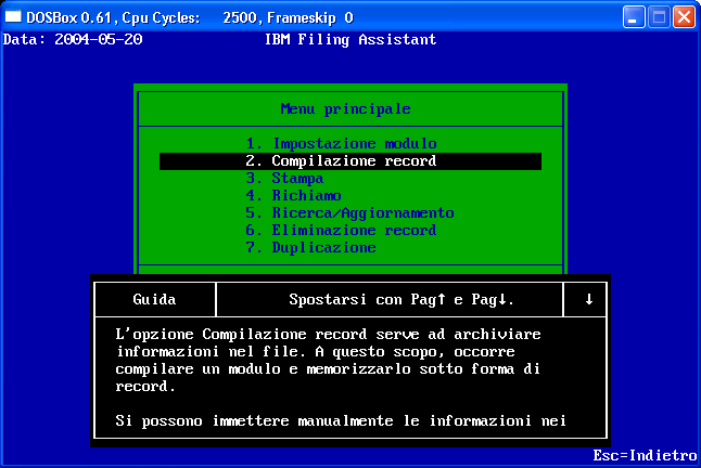

I have installed DosBox 0.61 on Win2000 Sp4 in order to permit me to run my old Dos program: IBM Filing Assistant 2.0 where I have scheduled over 2000 articles with its parts fro my hobbies because this program run only under DOS or Windows 98 operating system and not under Win2000 or Windows Xp.
Your program is a light and easy program but don't permit me to run it.
My program have a protection that when I installing it, the program create in the root of hard disk a file with attrubite HSRA (Hidden, System, Read Only, Archive) activate. If this attribute are OFF the program don't run also in DOS.
Your program when open the Box show this file with its attribute OFF, also if they are ON, and the command "Attrib" don't exist in the Box.

I am sorry to disturb you another time but you have answered me this: "You can already do this. Read the README.", but I have printed and readed all the README and there are not writed how I can maintain a file with its attributes HSRA (Hidden,System,Read, Archive) active in DosBox when these attributes of this file under Win2000 are already set to ON.
(The file infact is invisible to system under Win2000, but for DoxBox is visible and for this reason the Program IBM Filing Assistant don't run). Prove also you if you will want be sure that I told you.
DosBox don't respect original files attribute. It make all file visible and shows all files!!

You are correct, it appears that DOSBox does not respect file attributes such as Hidden and System (and perhaps also the Archive and Read-Only attribute). I don't think there is anything you can do about this. The best you can do is to ask/hope that a developer will look into this problem and solve it for an upcoming version.
Some DOS commands like DIR and TYPE are built into the DOS command interpreter (the program that displays the C:> prompt). DOSBox provides its own set of built-in commands (which you can see by typing HELP). Unfortunately, the ATTRIB command is also not supported by DOSBox, and that is why DOSBox gives you the "Illegal command" message.
I do not think DOSBox is able to run "IBM Filing Assistant" - at least for now. I tried to install it in my DOSBox, but all I got was a blue window. Similar, trying to run it from Windows XP, also just gave me a blue screen.
Perhaps in a later version with better support for those file attributes - Sorry!

The Blue Screen appear because Program IBM Filing Assistant 2.0 test the file "File.SyS": If it exist in root C:\ and if their attributes are ON.
If it doesn't exist or don't have attributes ON the program go into protection mode showing a blue screen and don't run.

Don't know if it helps, but try to change the byte at
0x2e31 in file.exe from 0xf9 to 0x01.
This should render the program usable with dosbox as
well as XP (maybe still not usable in the way you need
it, but give it a try).

😀))))))) Thank you very much WD !! YuhhhhUuuuu !!! Yeeeaahhh 😀)
I'm very very happy.
I don't know what you have done, but is so as I want the program run.
Very Great Great Work!!
DosBox + Filing Assistant Patched and all my problems are solved thanks to you.

> Dissassembled the code, and jumped around the file check?
No, just jumped out of the infinity-loop.
