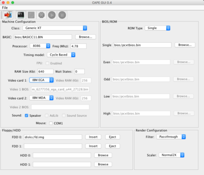

The launching GUI also has now multi adapter support as well.
99.25 KiB
692 views
GUI
Things will get a bit slow because cycle emulating 2 adapter+CPU is not fast 🙁
EDIT: the reason it is running slow in the screenshot (2.4Mhz) is because that was a debug build. It can run XT at full speeds, even with 2 adapters.

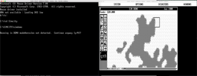

Here is another screenshot of a XT with an EGA and a Hercules this time around playing Simcity Demo on the second card (the Hercules). I am not sure why it thinks it did not detect a Hercules but it runs fine.

Well, the only way I've ever heard of to 'detect' a Hercules is to try and switch it to graphics mode, and measure the time between vbls.
If the game is doing that, then perhaps the timing is not what it expects (on real Hercules, you have slightly less pixels per scanline in graphics mode than in text mode, but the pixel clock is the same, so the framerate is slightly higher, enough that you can measure it).

You mean the fact that it has 348 scanlines instead of 350? (graphics vs text) That would make the vblank shorter yes. I'm missing proper timing for Hercules emulation so I will need to add that. The original Hercules also has some other quirks as opposed to clones (or an MDA) and I want to add support for that too, for completness sake.
No, that's not it.
It has 348 *visible* scanlines in graphics mode. However, there are 2 more invisible scanlines (vertical total (adjust)), so in both text and graphics mode, you have 370 scanlines in total.
I mean the length of a scanline is different.
Namely, in text mode, you have characters of 9 bits wide. The total width is set to 98 characters, so 98*9 = 882 pixels.
In graphics mode, the layout is 'characters' of 16 bits wide (the 6845 can only address in terms of characters in width and height).
You can't match 882 pixels exactly with that. You could use 55 characters, so you'd get 55*16 = 880.
For some reason however, Hercules programs them to 54 characters, so 54*16 = 864 pixels.
The pixel clock is the same in both modes. But in text mode you have 370*882 = 326340 pixels per frame, while in graphics mode you only have 370*864 = 319680 pixels per frame.
So that is a difference of a few percent, enough to measure.
