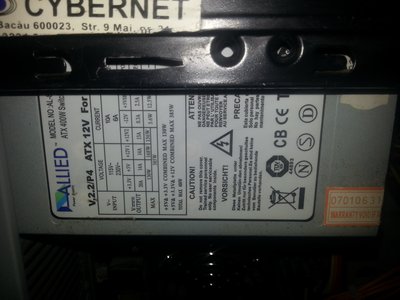

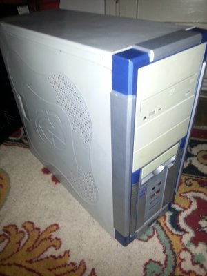

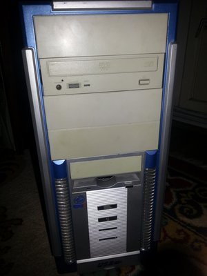

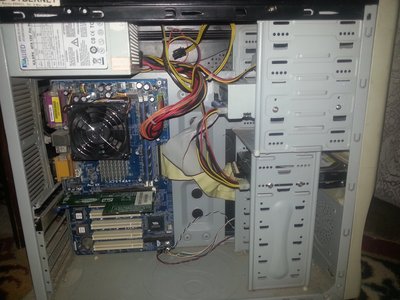

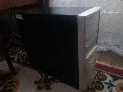

As I promised,here are some pictures.
Unfortunately the K7VT4A+ died (Super IO gets burning hot and will not spin any fan or anything) and the only KT400A replacement I have isn't POSTing. (Gigabyte GA-7VA)
For the time being,I put a Matsonic MS-8137C+ (ECS K7VTA2 rev2.0 (SDR+DDR)/Syntax SV266A - Syntax did a better job at rebranding ECS) along with a MX440 64MB.
