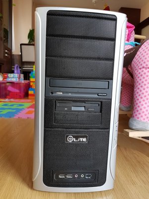

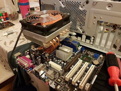

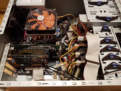

I built universal PC with Windows XP SP3, Windows 98 SE with DOS 7.1.
Works Windows old games (Flight Unlimited for Windows 95), Dos games with SB 16 emulation on SB Live!
My configuration:
Case: Cooler Master elite 331
Power supply: Chieftec GPS-350EB-101A 350W
Motherboard: ASROCK 775i65G R3.0
CPU: Intel Dual Core E5800 3.2 GHz
GPU: EVGA GeForce 6800 128MB AGP
RAM: KINGSTON HYPERX KHX3200AK2/2G - 2GB RAM
Sound: Creative Sound Blaster LIVE 5.1 SB0100 PCI
3 x disk Hitachi: 80 GB, 120 GB, 200 GB
CD-ROM: LG 52x ATAPI
FDD: NEC 3.5"

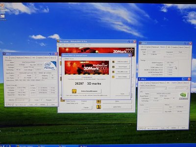

For me ASROCK 775i65G R3.0 is the best, because it works a lot of processors on this motherboard http://www.asrock.com/mb/Intel/775i65G%20R3.0 … .pl.asp?cat=CPU. The CPU intel E5800 is very fast as for AGP board, I tried Intel Dual Core E6800 3.33 GHz, but it didn't want to work after computer restart.
My Geforce 6800 AGP benchmark 3DMark2001 SE default settings - 26297
My Geforce 5900 XT Benchmark 3DMark2001 SE default settings - 7939
Computer takes about 180 - 260 Watts of power.

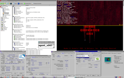

Reply 3 of 8, by agent_x007
tomoa wrote:
As You can see Intel Pentium 4 and Pentium D is very weak against Intel Core 2 Duo and Pentium Dual Core.
If you overclock Pentium Extreme hard enough, it can get close to Q6600 2,4GHz @ 2 Cores score : LINK ;D
I'm GUESSING results are from latest PES CPU test.
Reply 4 of 8, by tomoa
agent_x007 wrote:
If I put the Pentium Dual Core or Core 2 Duo on this RAMPAGE EXTREME board, I will get extreme results for these processors much better then on AGP boards. This is PCI-E board and special for overclocking.
I don't think Windows 98 run on this motherboard.
Poland , http://komputery-retro.ddns.net/ http://komputery-retro.ddns.net/blog/ , I like old games and old computers 😀
Reply 5 of 8, by agent_x007
tomoa wrote:
RAMPAGE EXTREME board... This is PCI-E board and special for overclocking.
Now that gives me an interesting idea... thank you 😀
Reward, a future upgrade for universal machine 😉

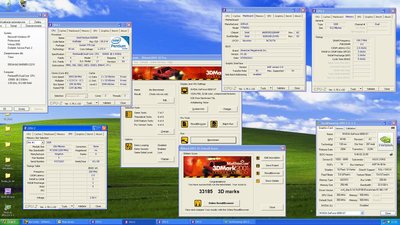

Reply 7 of 8, by tomoa
Board: Asrock 775i65G R3.0
Processor: Pentium E6500K
RAM: Kingston CL2 2x256 MB
Graphics Card: Geforce 6800 GT DDR3 AGP - without OC
3DMark2001SE: 33185
Please compare hardware which can run under Windows 98 SE without modified drivers.
