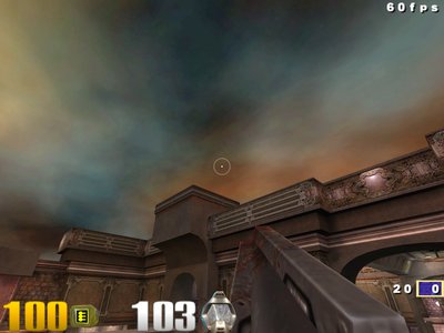

Both GeForce and Radeon have some picture quality issues btw.
For example here's how Quake 3 sky looks on a VSA100 (Voodoo 4) card in True color (picture for reference):

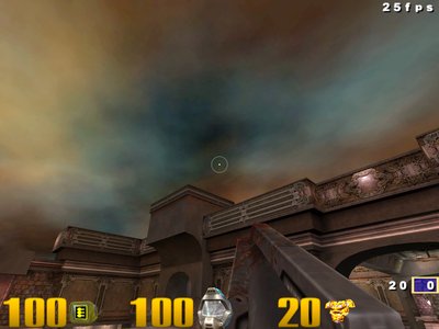

And here's how Quake 3 sky is rendered on any GeForce before G80 family (notice very blocky color pattern):
740.66 KiB
4477 views
As far as I remember, this problem is less pronounced on a Radeon cards of that era but probably still there.

Reply 3 of 123, by The Serpent Rider
It's not S3TC bug and this problem is not exclusive to Quake 3 sky.

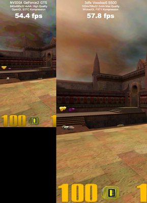

Reply 11 of 123, by falloutboy

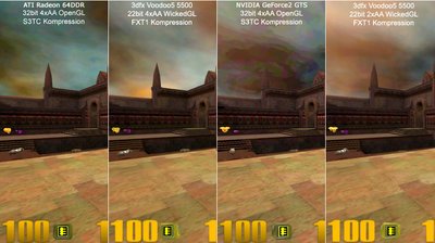

Back then when Quake 3 had texture compression enabled by default.
3dfx in 16-bit vs 32-bit of the competition. (WickedGL driver improves performance for the Voodoo5)
Credits for the screenshots go to Mr. Lolman from http://www.forum-3dcenter.org
157.51 KiB
4517 views
129.76 KiB
4517 views

Yes, blocky color transitions can be seen in System Shock 2 looking closer to a wall. Tested with Geforce3 Ti 200 & GeforceFX 5900XT. It does not happen on Voodoo3 & Radeon 9700 Pro.
I also have seen it in Max Payne 2, but only on a single wall. In most games I haven't noticed anything, but I don't have much experience with older Geforce cards (went from Voodoo 3 3000 to Radeon 9700 Pro back in the day).
Reply 14 of 123, by The Serpent Rider
swaaye wrote:
GeForce cards prior to GeForce 4 have 16-bit DXT1 processing and they didn't dither it very well.
Both screenshots were taken without texture compression. You can double check it on any GeForce 1-7. On DX10 and newer cards like GeForce 8800 you'll get Voodoo 4-5 quality.

What about the PowerVR Kyro II? I find the image it delivers really nice and crisp.
Same as GeForce cards (bad):
    750.31 KiB
    4462 views

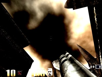

Reply 17 of 123, by PhilsComputerLab

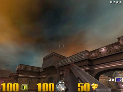

So this is with a GeForce2 GTS and 45.23 driver.
To my eyes these look nicer than the screenshots posted?
YouTube, Facebook, Website

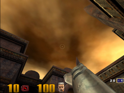

Reply 18 of 123, by PhilsComputerLab
1600 x 1200

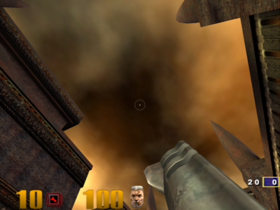

Reply 19 of 123, by The Serpent Rider
swaaye wrote:
I'd like to see what the actual texture image looks like.
That would require software rendering, with linear texture filtering no less. VSA100 or modern GPU are pretty much as close as you can get to the reference.
Not really, blocky pattern is still there:
