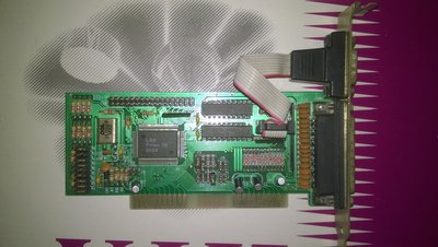

Please can someone explain a bit about the interfaces on this card? I'd like to learn more about it. It's a Goldstar 16-bit ISA multi I/O PC controller card, model: IDE Plus V3L, 002. It's got two 10 pin male connectors that are labelled ASYN1 and ASYN2. Are these serial ports? Is that the same thing as a "COM PORT"? Would that be for a mouse? (Why have two of them?) Would they require a "special" type of cable? (Presumably you couldn't just attach a serial mouse "directly" to them?)
Also, there are two female ports on the backplate. They have 15 and 25 pin holes. Is the 15 pin port for a joystick? (If so, would that be called a "game port"?) I guess the 25 pin port is the parallel port. Is this sometimes referred to as "LPT", and is it just used for printing? Is the connector itself known as "DB-25", and if so, what does DB stand for? Regarding its IDE connector, would that allow an IDE CD-ROM drive to be attached to its primary/master HDD as a slave device?
Thanks a lot for any comments! 😀
The Goldstar controller -
9ENdp35rjjaBb1uU-UM4doExcvWANBQkAB6OXjlyNQDH87wDxsSOlCaEMJI2MQNoMjIPEn90dyAqr41QaPK6cc88RONRMMuJHECFSe7TE2yn1cf8QatyQ5ujPX2ccdVST-btiKR_MjQjvwQEHFSEphS8JBDVH0v0tob2n5K9Gh6WI9DJoqH7sarnYr_Yjk9OxK67D1o8ErQXvpAurB_JzAF-PfjcSi-8gkYy8jOR4V5rlS7pTPsw2LJ44gaEcEllcvgSUQrH3VMcukcX0glYNPlC7whE_koDQiQEbu3EFtfZh-9RGvCVbWyWR3j61ui2b4DAmSoKAIvUkk4FT-8OOSa3Mr2T0JFQnCL3Ace-V0Ggq_SATT5p7_V6SpjIaOmwAQuVnsRUaHx9B_UuPQXraY3P1ANt3UmAvrKkSH0PSQB1gUBkLu8mGzYJT9L-npZTG5LoGeeMtMjPf8QO5spKTrV9YX5e5XzzjaUsPXwRo5_dLVmEgA7iNoDFNm4ng_ETqVoILXke3aUQUogXQdXCxUuTntrd-ogcIHhVx__loOWLLes-zPkYYBQFkzj03N1X-dZYwf2JM7ynE0TINEr-I5pZqg7qRugLGOCWU4UucIx8R92clJcV=w917-h659-no

ASYN1 and ASYN2 = Serial = Com-Port 1+2
One can be used for a serial mouse, the other for a serial connection to an old mac (adtpro) if you build a special cable.
The other could also be used for an atari-st or amiga serial connection.

Another common use for a serial port was modems, so it made perfect sense to have more that one.
A CDROM should work on this IDE connector, but I HAVE come across similar controllers not working with ATAPI drives. So the answer is most probably yes, but it's not certain without confirming it in practice of from the manual.

The serial ports (ASYN) just need an adapter that brings the wires to a bracket in unused slot next to the IO controller. There are a couple of different pinouts so don't assume the first you find is a correct one. But the bracket will have 9-pin serial and 25-pin serial connectors (DE-9 and DB-25 male connectors). The adapter looks so new it should have 16550A UART with a 16-byte FIFO handling the COM ports. In the era before PS/2 mice, the DE-9 connector was used for mice and DB-25 unused or for any other serial device like modem, printer, another PC, etc. Other than the connector size there no difference.
15-pin connector is game port. But it looks like there is a catch. Based on the count of wires and the NE556 dual timer chip, the joystick port can support only one standard 2-axis 2-button joystick. Normally there would be more than 10 wires and NE558 quad timer chip to support a full 4-axis 4-button gameport.
25-pin DB-25 connector is the parallel port (LPT). Mostly used for printing, but you can connect any other devices with parallel port too, like scanners, ZIP drives, COVOX or Disney Sound Source sound devices. DB-25 means "D-subminiature" connector, B is the length of the connector and 25 is the pin count. Therefore, serial mice and digital monitors have DE-9 connectors and VGA is a DE-15 as they are mechanically the same length but with different pin counts.
The IDE connector can most likely take a IDE CD-ROM as a slave, but most likely that is at the primary IDE interface address by default so if you already have an IDE interface in your system you have to configure one of them as primary and other as secondary. Each IDE interface can take two devices, and in theory there should be no difference if they are master or slave but sometimes it's best to jumper drives as master if it is the only device on interface. If this is the only IDE interface in your system, it should work with HDD as master and CDROM as slave.

Thanks a lot keropi, and awesome info Jepael, many thanks. I have some follow-up questions please:
* Regarding the two ASYN male pin connections on the card's PCB. Would the corresponding DB-25 serial port connector (male) be for something called an "RS-232" port?
* Would ASYN1 always lead (go) to a DE-9 serial mouse port, and ASYN2 always lead to the other lesser used DB-25 serial port? Or, could they be switched around, so that the cable from the ASYN1 connector lead (went) to a DB-25 serial port on the backplate?
* Is it true that a female port (on the backplate) is always a parallel connection, and a male port (backplate) is always serial?
* Regarding the Dx lettering; B and E. At first glance, I thought that these letters might represent hexidecimal values. However, it seems that the shorter length is associated with a 'larger' letter, and so there must be another explanation. Are these letters simply "categories", used for simple "grouping"? Or, do these letters actually represent something?
* Regarding the controller's configuration, namely its main bank of jumpers (JP1 to JP11), and also its single JP12 jumper, does anyone have a jumper settings description for these please?
Thanks a lot!

25-pin and 9-pin serial ports are functionally identical, and in fact you can use an adapter to connect a device with one connector to a port with the other. Serial ports use the RS-232 standard, yes, so if you hear of an RS-232 port, that's the same thing as a serial port or COM port. A few weirdos call them TTY ports sometimes too.
It's common - but by no means universal - for the first port to be 9-pin and the second to be 25-pin, but since they're functionally identical, you could reverse that. On some early PCs, both were 25-pin. On later ones (most ATX motherboards, for example, before they starting phasing out serial ports) both were 9-pin.
Not quite, especially outside the realm of PCs. However, you can generally assume that a female 25-pin port is parallel, unless it's marked as SCSI, and that a male 9-pin or 25-pin port is probably serial. There are exceptions, but not usually on multi-I/O controllers like this one.
As far as I know, they're just categories.
Thanks a lot!
I'm afraid I don't... All the ones I have, have different jumper blocks which are generally clearly marked. Yours, alas, is one of the annoying ones that doesn't have them marked.

Yes, COM (communication) ports use signals and voltage levels compatible with RS-232.
You can connect them in any way you want. There is no much difference, other than COM2 (address 0x2F8) uses higher priority interrupt (IRQ3) than COM1 (address 0x3F8) which uses IRQ4, but that may be irrelevant. Mouse is a slow 1200 bps device while modems were used at highest possible rate of 115200 bps.
On a multi-IO card yes, but otherwise on other cards they could be anything. For example network cards have AUI connector identical to game port.
https://en.wikipedia.org/wiki/D-subminiature
Might be hard to find that info specific to card you have, as there are so many cards with same chipset. Fortunately it is near impossible to break anything, I've once determined jumper settings by changing one of them at a time and rebooting the PC.
First hit with google provided this:ftp://www.bf.lu.lv/pub/OS/I_O/Goldstar/prime2ide.html
