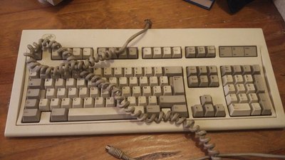

IBM Model M French Layout. Pretty good shape, not so yellowish. Got it for about 50 bucks on "leboncoin", kinda most popular "french craiglist".
I had found a Model F French layout, but the guy did not want to split the lot he was selling.

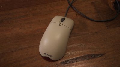

Microsoft Optical Mouse. I really wasn't incline to go for ball mouse. Still feels pretty classic. Got it for 3 bucks locally

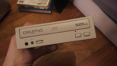

Standard CD drive. Though, I do really like CREATIVE. This brand belongs to this gaming era IMO. I like that typography.

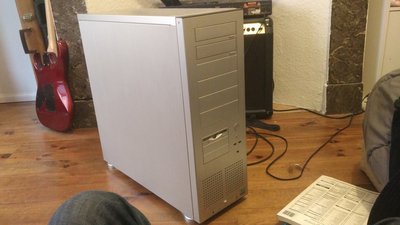

Here is the case. Lian-Li PC70 I guess. Got it on the "french craiglist" for 90 bucks, delivered to my house. It includes power suply, and looks pretty brand new, and complete. Multiple fans regulators, and USB front panel. Steel build like a tank

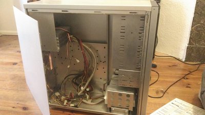

Here is the inside of the case

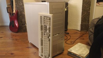

This thing is HUGE.

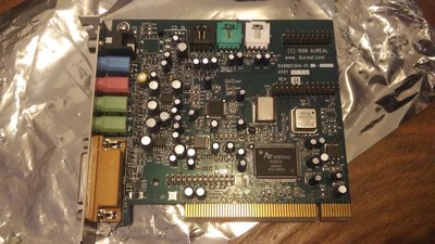

So here is the soundcard, as you can see, Aureal Vortex 2, new old stock.

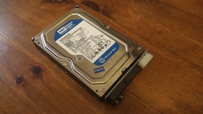

I choose brand new SATA Hard drive with SATA->IDE adapter. This will be more reliable.
Though, I am intereseted in getting an scsi controller and some 10000rpm. Will see

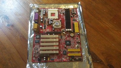

So, here is the motherboard. MSI KT3 Ultra2. Got it fo 25 bucks.
I was originaly looking for an Epox 8k5a3+ which seems to be kinda hard to find for a good price. Only find one in months, for almost 200 bucks.
Maybe some day

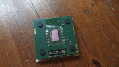

A Barton 3000+ 333MhZ to throw in it using latest bios.

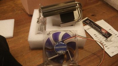

This is the Thermalright SI 97. Got it to the same guy to whom I bought the CD drive.
Pretty complete in the box.
I'll pair it with a 92mm noiseblocker

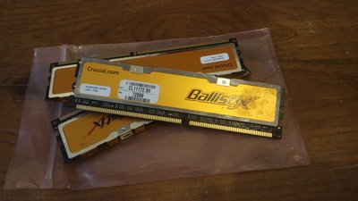

This is 3*512 DDR400 Crucial Ballistix rated 2-2-2-6.
Got it for 20 bucks. Kinda nice deal
Though, these will run 333

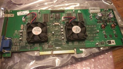

And here is the V5. Pretty hard to find for a good price this days. Auctions on ebay are going crazy.
Got it on a "german craiglist". The guy was nice, and agreed to send it to my place.
Got it for 135.

You have a quite interesting project. A high-end year 2000-2001 system with a 2004 cpu...
The Thermalright SI97 with noiseblocker and a fast 10-15k SCSI drive is some kind of diverging.
Do you want high fan and hdd performance regardless the noise or (i would perform...) a silent PC?

1.5Gb ram is too much for win98...

Since that mobo is able to eat a 3000+, I said to myself why not ?

About the OS, It's for that kind of advice I'm here. I'm going for 98se. Max 512 ?

Your off to a very nice start! Would love a Voodoo 5 but not enough for the prices they demand.
I agree with you on Creative CD-ROM drives, They are not that good, even compared to other drives from the same era but is something quite retro about them.
Me too.
I've got a GF2 GTS for 1€ last year, a compareable card to the V5, but i wouldn't pay these incredible prices today...
It's like it is, the market regulate pricing...

Cool case, I love those Lian-li (and not because I had a similar one, but smaller and served me well from 2003 to the last year 😁 ). You're lucky that you have also the original bezels, they cost me a fortune to buy them additionally back at the time.

Some very nice choices. I recommend you run Win98SE with 512MB RAM.
I run an Adaptec 2940UW with a 10,000 RPM drive. These parts are expensive and you'll need to have some method of cooling the hard drive. With a 15,000 RPM drive, the cooling will become even more important. I really think you should just use ATA133. It's much cheaper, quieter, cooler, and performance will be about the same.

Another useful feature of lian-li case is that is made of aluminium. So in fact it works as large HDD cooler (which has it downsides in this case as the drives are screwed right into chassis and transfer vibrations and noise), in my experience one slow 80mm fan at the front of the case, where is a dust filter, is more than sufficient for cooling 2 - 3 drives.
