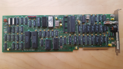

The CPU card (sadly no co-pro, not that it's needed but, you know...):

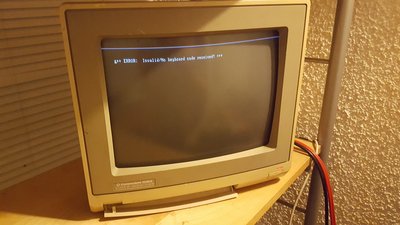

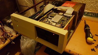

The system cleaned up and powered on:

Reply 3 of 5, by DeafPK
Lovely design of that case. Could we get a top-down photo showing more of the internals? 😀 I've got a Zenith Z-Station Pentium machine. It's a pizza-box style PC with a riser. Perhaps one of the latest models? Interesting story about the brand there, thanks for sharing.

Reply 4 of 5, by brassicGamer
I've got a video in the works but yeah I can upload some pics of the insides. When you look at one of these next to an XT the advantages to the design decisions are clear: the PSU and floppy drives are significantly smaller in size, effectively offering double the space for expansion, a big factor that gave this system appeal over the XT. Competition is definitely good. 😀
