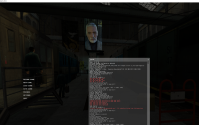

Reply 8 of 18, by silikone
Launching it gives me an error of a texture not loading, and opening the renamed GCFs, I can see that some of the files are still encrypted.
This tool says nothing about this. Is this a quirk on this specific release, an English pan-European release on DVD?

Reply 15 of 18, by DosFreak
Didn't have any luck with the Orange Box. SID extractor extracted all of the files and the game launches and then crashes,thinking the SID extractor corrupted some files or mabye it was released on the disc as broken and the only fix is updating from Steam.
Tried pheonix and simpack. Simpack just crashes.
