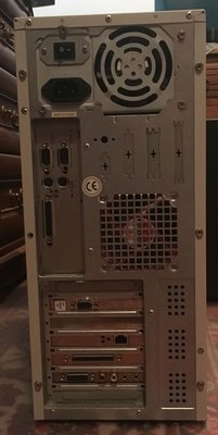

Some photos:
82.3 KiB
1928 views

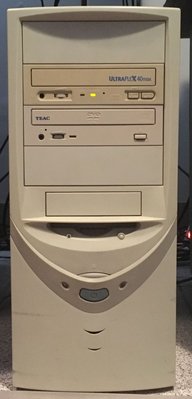

Beige tower
133.82 KiB
1928 views
Back
269.66 KiB
1928 views

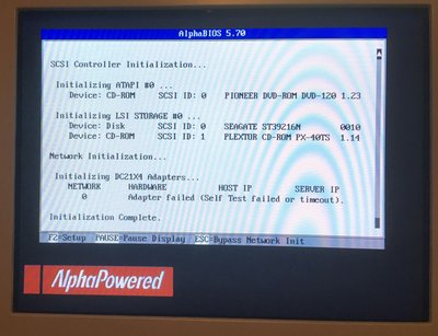

AlphaBIOS

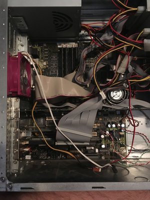

Inside the AlphaPC

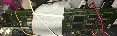

Reply 1 of 30, by GL1zdA
More pics:
198.18 KiB
1927 views
Compaq PowerStorm 300
Windows desktop (latest versions of Total Commander and IrfanView run with help of the FX!32 emulation layer), look at the PIDs - you won't see such values on a PC:

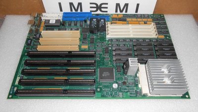

I have the AXPpci33 AT Alpha board, but after flashing it to ARC it wouldn't boot 🙁 It looks like this one:

Reply 6 of 30, by matze79
That's the board I couldn't get to post 🤣
