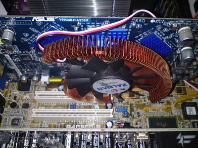

    I have replaced the stock cooler on the GeForce4 (an Asus V8460 Ultra Deluxe). It always worked OK (way better than those GeForce4 standard coolers), but the fan is quite loud nowadays. Disassembling the unit I was kind of surprised to find zero thermal paste/pads on the RAM chips. The card is now fitted with my spare (new in box) Zalman VF700-AlCu and should therefore be properly cooled. The fan is close to inaudible.
    For the GeForce FX I wanted to replace the cooler too. The card is an Asus V9950 Ultra and as such has a dual fan cooler which is quite loud too (at least it feels like this nowadays). This actually isn't the first FX 5900 Ultra I had. The first one (same model) died within the warranty. I got a new one from Asus which I used for a few months until I upgraded to the next model. When I now disassembled the heatsink unit I found it to be poorly installed. The GPU was only partially covered with thermal paste, the lower third of the chip had no thermal paste at all while the center of the chip had a little, the upper third looked OK. Seemed like there were three drops of thermal paste, two in the upper third, one in the center, that's it. But the amount used was not enough to get it spread out over the entire chip by the contact pressure. I'm very happy that this card did not die due to the sloppy heatsink installation. It now has a Zalman VF700-Cu on it (also new in box, I bought it but replaced the card I wanted to use it on before it could install the heatsink), which should provide enough heat dissipation given the stock cooler wasn't even mounted correctly. And the fan noise is also close to inaudible.

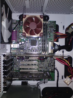

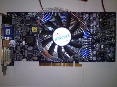

Another update... This time, I got a little more done. I had some time in the evening and started disassembling the old Retro 2 and Retro 4. Then I installed the parts for the new Retro 2, as per the plan. The configuration is now as follows.
Retro 2 (3dfx Glide Games):
System specifications:
  • CPU: Intel Pentium III-S 1,40GHz (CPU-Z)
    Cooler: Thermaltake Volcano 12 + Noctua NF-A8 FLX
    Mainboard: Intel D815EEA2 (BIOS P15)
    RAM: Micron 512MB PC133 CL2 (2x 256MB)

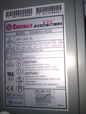

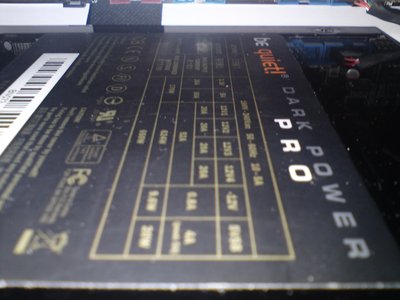

    PSU: Enermax EG465AX-VE(G)FM 460W
    Case: Fractal Design Define R5
Add-in cards:
  • AGP: 3dfx Voodoo5 5500 AGP 64MB & 3dfx Voodoo5 6000 AGP 128MB (Rev. 3700A, Full PCI Rework)
    PCI4: Creative Labs Sound Blaster Audigy2 ZS
Drives:
  • FDD: N/A
    SSD1: SanDisk SDSSDA-120G-G27 120GB (Voodoo5 5500 AGP)
    SSD2: SanDisk SDSSDP-064G-G25 64GB (Voodoo5 6000 AGP)
    ODD: HP GDR-H30N
Game Controllers:
  • Gameport: Microsoft SideWinder Game Pad
    Gameport: Microsoft SideWinder Precision Pro
I/O Devices (via KVM):
  • Display: Eizo FlexScan F520
    Keyboard: Microsoft Natural Keyboard Pro
    Mouse: Microsoft IntelliMouse Optical
    Speaker: Canton Plus Media 3
Operating System (Voodoo5 5500 AGP, SSD1):
Operating System (Voodoo5 6000 AGP, SSD2):
  • Dual boot via Boot-US
    OS1: Windows 98SE
    OS2: Windows 2000 Professional SP4
Overview of currently installed software: Link

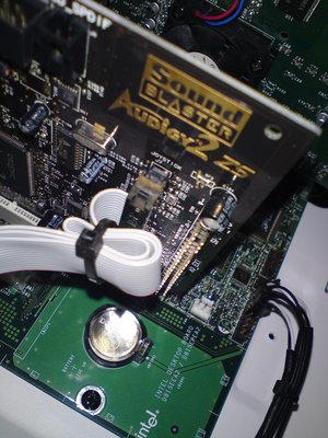

A few pictures of the system:
    2.06 MiB
    8818 views
    System Overview
    2.2 MiB
    8818 views
    Pentium III-S 1.4GHz & 2x 256MB Micron PC133
    2.27 MiB
    8818 views
    Voodoo5 5500 AGP
    2.15 MiB
    8818 views

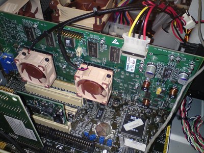

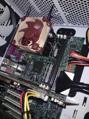

Note: The cable ties on the CPU heat sink are supposed to prevent the latter from crashing down onto the add-in cards in case the socket mounting points for the heat sink clamp should ever break. I did this because this is an all-copper heat sink and as such is a little heavy. And because this is a socket 370 (obviously) there is no option to screw the heat sink to a backplate, there are only the little plastic studs on the socket. Plus, I'm a little paranoid 😉 And of course they take part of the heat sink weight off the socket.

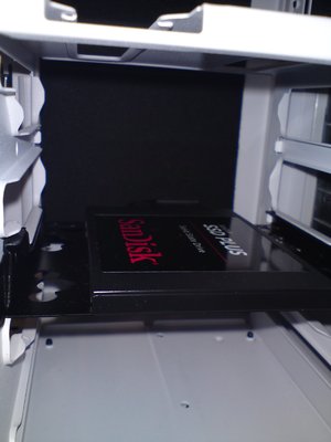

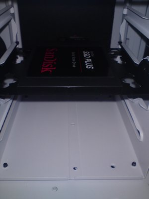

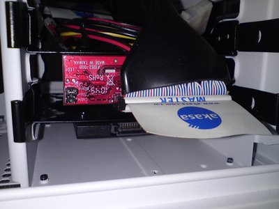

    493.26 KiB
    6522 views
    SanDisk SSD (120GB) behind SATA to IDE converter + SanDisk SSD (64GB)
    1.97 MiB
    8816 views
    Enermax PSU

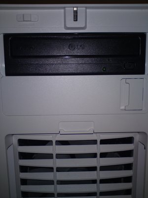

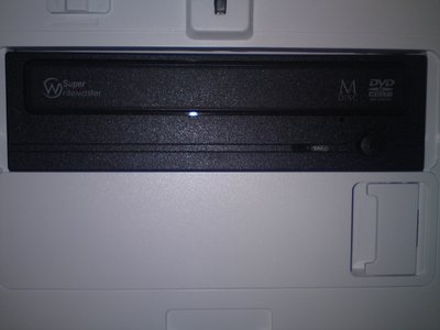

    HP DVD drive
I used a black DVD drive to keep the black-white contrast of the Fractal case.

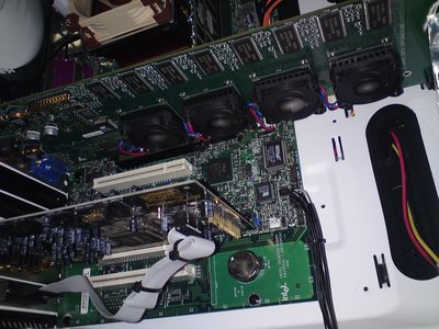

And here's the other graphics card for this system, my most valuable piece of hardware...
    2.19 MiB
    8816 views
    Voodoo5 6000

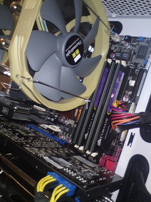

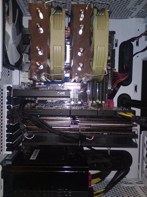

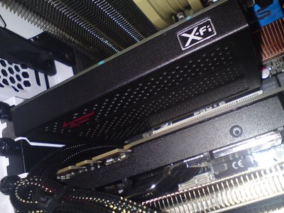

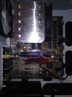

After completing the hardware configuration of Retro 2, I started with Retro 4. Since this is an entirely new system (i.e. no stripping parts and cables cables off a case) I thought it shouldn't take too long.

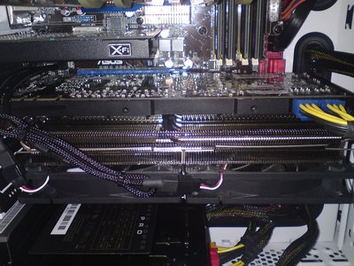

A few days ago I already had disassembled the stock cooler of the GTX 580. I wanted to use the stock cooler's base plate for memory and VRM cooling, if the Morpheus would fit over that. Annoyingly, the base plate has the fan unit attached via three screws. This means you have to completely remove the base plate from the card in order to reach the screws. Actually, then you still can only reach one of those screws. The other two are covered by thermal pads for the VRM area. After removing the fan and the plastic cover for the power connectors I reinstalled the base plate and checked whether the Morpheus can make contact to the GPU. It can! After applying thermal paste, I installed the Morpheus heat sink and two NB BlackSilent Pro PL-1 120mm fans. Done!
Yesterday, I then started to assemble the entire system. As those parts are all pretty modern (as I wrote in the initial post, Retro 4 is not really that "retro" overall, my personal definition just happens to be "what I cannot do on my main rig anymore is retro") there were no issues at all other than trying to hide most of the cables. Of the four retro machines Retro 4 is the most modern one. Although, all parts have Windows XP support (Retro 4's intended use: Run late WinXP and early WinVista/DX10 games). This can't be done with my main rig where most of the parts never even had Windows XP support to begin with. I had to use a new SanDisk 240GB SSD because the Kingston drive has already been used someplace else. Other than that, no changes to the plan initially outlined.
Retro 4 (Late XP Games/Early DX10 Games):
  • CPU: Intel Xeon X5470 4x 3,33GHz (CPU-Z)
    Cooler: Thermalright Silver-Arrow
    Mainboard: Asus P5Q-E
    RAM: Corsair 8GB PC2-8500 CL5 DDR2 1066 (4x 2GB)
    PSU: Be Quiet! Dark Power Pro (P7) 650W
Add-in cards:
  • PCIe x16: Evga GeForce GTX 580 3 GB + Stock cooler base plate + Raijintek Morpheus + 2x Noiseblocker NB-Blacksilent Pro PL-1 120mm
    PCIe x1: Creative Labs Sound Blaster X-Fi Titanium Fatal1ty Professional
Drives:
  • FDD: N/A
    SSD: SanDisk SDSSDA-240G-G26 240GB
    ODD: Samsung SH-224GB/BEBE
Game Controllers:
  • USB: Microsoft Xbox 360 Controller for Windows
Operating System:
Overview of currently installed Software: Link
    2.25 MiB
    8768 views
    System Overview
    2.31 MiB
    8768 views
    Xeon X5470 + 4x 2GB Corsair PC2-6400

    SanDisk SSD

    Samsung DVD drive
Again, a black DVD drive because of the black-white contrast of the Factal case.

  • AGP: Asus V9950 Ultra 256MB (GeForce FX 5900 Ultra) + Zalman VF700-Cu & Asus V8460 Ultra Deluxe 128MB (GeForce4 Ti4600) + Zalman VF700-AlCu

    System Overview

    Sound Blaster X-Fi Xtreme Gamer Fatal1ty Pro.
    2.22 MiB
    8629 views
    SanDisk SSD

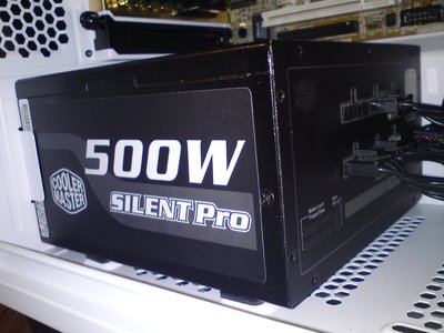

    Cooler Master PSU

And here the alternate graphics card, could also be used in Retro 2 since it is AGP 4x.
    2.19 MiB
    8629 views
    GeForce4 Ti4600

  • PCI1: 3dfx Voodoo5 5500 PCI 64MB + 2x Noctua NF-A4x20 FLX

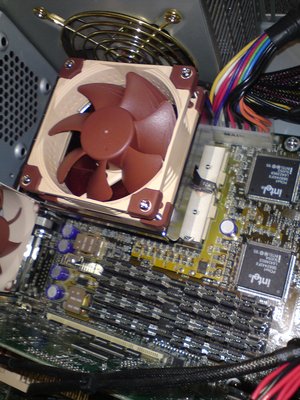

    Pentium Pro 200MHz 1M + 4x 32MB Kingston EDO

    Voodoo5 5500 PCI

    Enermax PSU

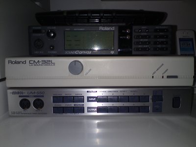

And the MIDI rack...
    2.08 MiB
    8614 views
    MIDI rack

Photos have been posted for each system, detailing most of the internals. Photos of the entire setup will follow after the clean-up.
