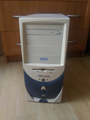

I decided to re-build my old gaming rig that served the teenage-me early to mid 2000s. Thought I'd share this with you guys 😀
601.76 KiB
643 views
The rig. Not the same case, however it has the same styling. I didn't save all my original parts, however the Video card, hard drive and ram are from the original machine.
Motherboard - Shuttle AK37, which uses the 12V rail to power the CPU. This 3 Euro purchase is how I am able to make a project like this work, since good 5V-heavy PSUs are so hard to come by these days
CPU - Athlon Thunderbird 1400C, running @ 1333Mhz (original was 1333MHz, but getting a 1400Mhz one today is cheaper for some reason...)
Video Card - Gefoce2 MX400
RAM: 256 MB DDR266 in single-channel (I remember the crappy original case wouldn't fit a second stick w/o removing the CD drive 🤣 . Not that I had a second one to put in there...)
Windows XP SP3 (I wanted SP2, however it doesn't play nice with my wifi adapter 😵 )
I ran some very basic tests on the games I played during that time: Battlefield 1942/Vietnam, Call of Duty, Counter-Strike 1.6, Mafia, Need for Speed Underground, Unreal Tournament, Red Alert 2, Stronghold Crusader, Rise of Nations, Worms 3D (which I cant understand why people hate so much) and Half-Life 2 (which I didn't really play until I got a new PC, even though I wanted to so bad, but I just didn't think it would run).

Thank you for the tip, gonna use use Vogons for images from now, it's easier that way anyway.
The harddrive is an IDE ExcelStor 80GB. Used it a lot in my older W9x builds as it has a handy jumper setting for a 32GB limit.
